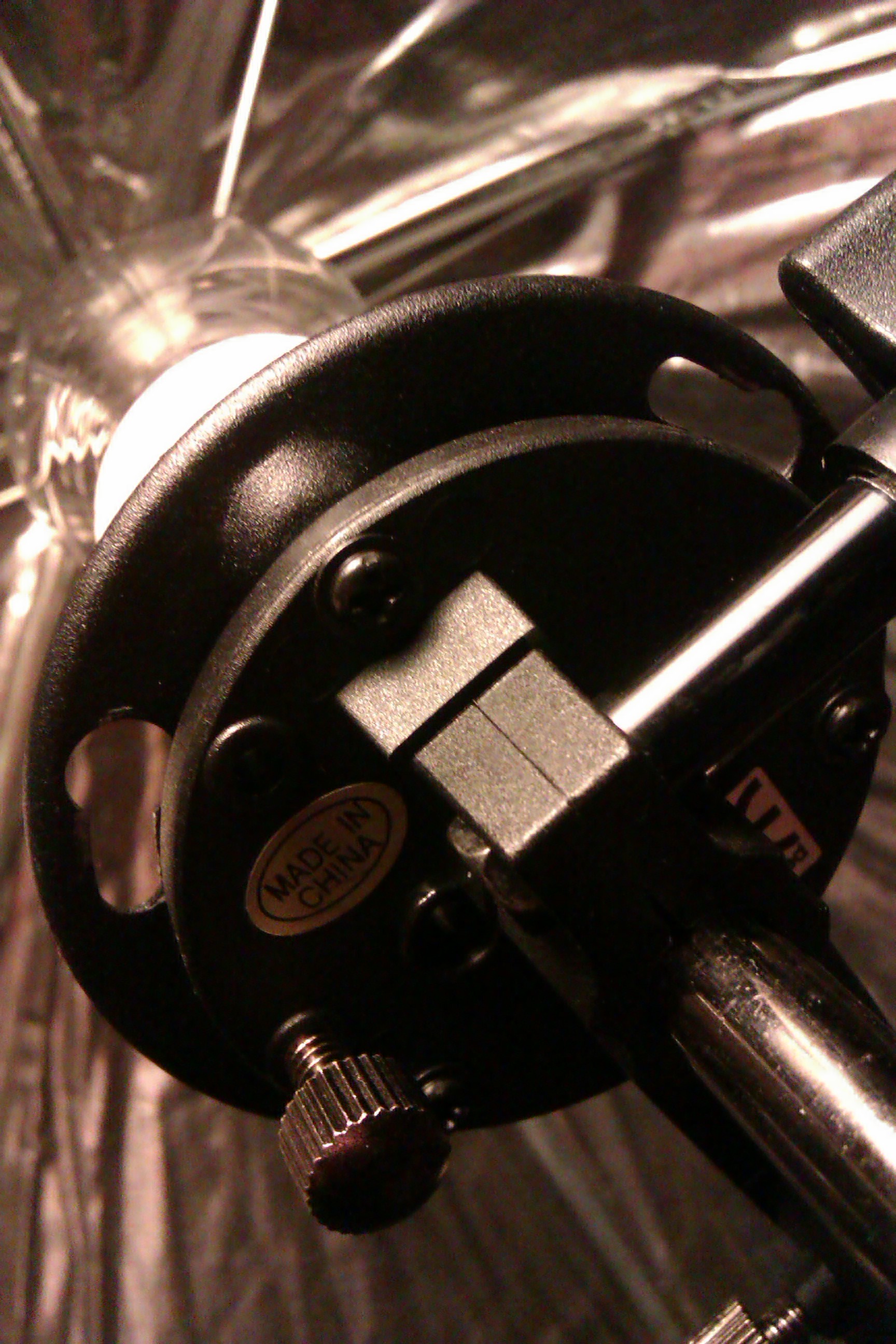

Here a foto of the thing which I want to couple the speed ring:

Ok- that's a proprietary mount. I think you'll have to just get the one they're selling and end up with an extra softbox. Which isn't necessarily a bad thing- not all softboxes are made to take the heat of a tungsten lamp and might melt/catch fire if used with too powerful a bulb. If they're selling one with the kit, it's probably made to take the heat from your lamp.
Thanks for the advice.
But I would be limited to only one softbox, meaning that I would need to replace all the 3 soft-boxes I have.
I wonder if it would not be worth buying a more universal system so I can use speed rings easier to find. Anyway... I see what I can get in the store tomorrow.
Thank you.
