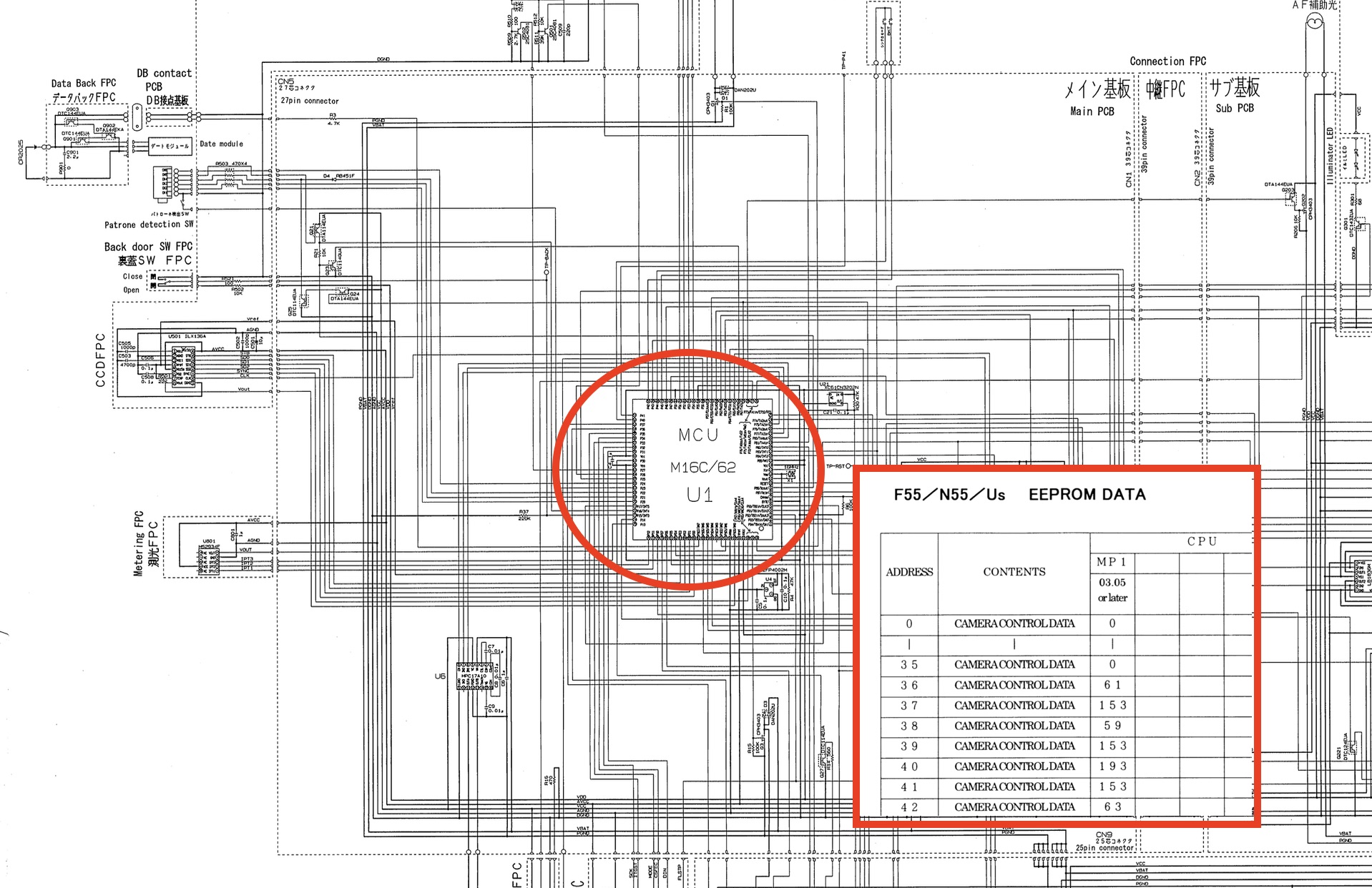

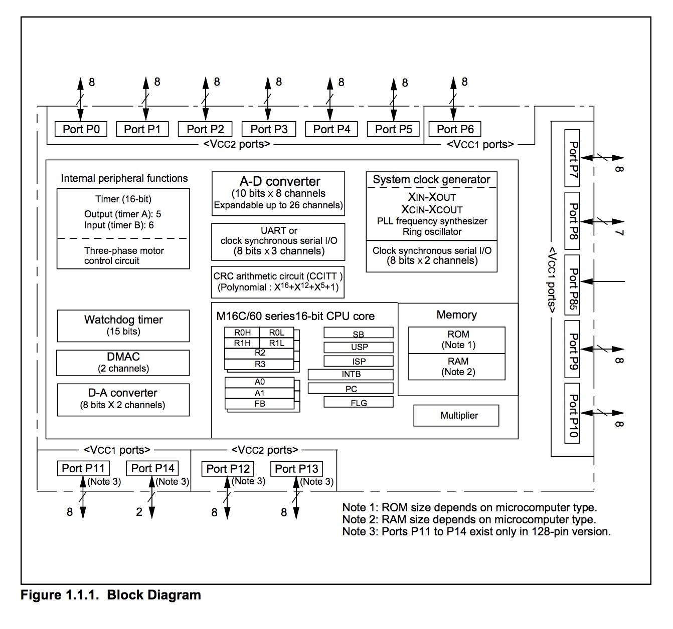

This is the schematic of a point and shoot. Most of the control of the camera is through the CPU, (M16C/62) the function of which is outlined in the block diagram.
