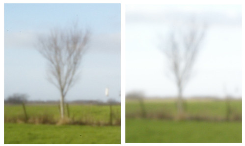

Just received a couple of double etched pinholes from http://www.pinholesolutions.co.uk/
Under the microscope they look really good and smooth £15 each, just to add to the thread.
I was using a set gifted which looked really rough under the 'scope but they worked. What was surprising, to me as a newbie in this branch, was the large visible difference in result using both just to test quickly on an M8. They don't play as nicely as with film I have found but it allows a quick and dirty test with feedback. Neither result is better it depends on what you want. This is a crop of 10% of the frame.
0.2mm LHS 0.3mm RHS

Chris, in your two examples, if the focal length was optimum for the 0.2mm pinhole and the same focal length was used for the 0.3mm, the increased blur is more likely due to the oversized pinhole than to everything else. Some "experts" who rely on others' claims without bothering to do extensive experimenting themselves might say that pinhole diameter is not critical. Not so. When the diameter departs from optimum by 20% or even 10%, the loss in on-axis sharpness is noticeable. When the diameter is 50% larger than optimum, the blur is doubled. I have no experience with etched or laser drilled pinholes, but doubt that they offer any advantage over pinholes properly made by traditional methods.

Jim, Indeed that was my conclusion, that size matters !!
The various formulae for calculating the optimum appear to rely on a purely mathematical terms, but reach differing coclusions. Is there any source for a systematic experimental exploration or is the definition of sharpness too hard to pin (sorry) down?
In my case I would like to explore a series diverging by say 0.02mm around the 0.2mm whilst realising that optimising for 35mm film is not optimising at all really.
The pinhole world appears to revel in a rough and ready approach which is at once refreshing but unsettling for those of us raised on double blind crossover trials.
