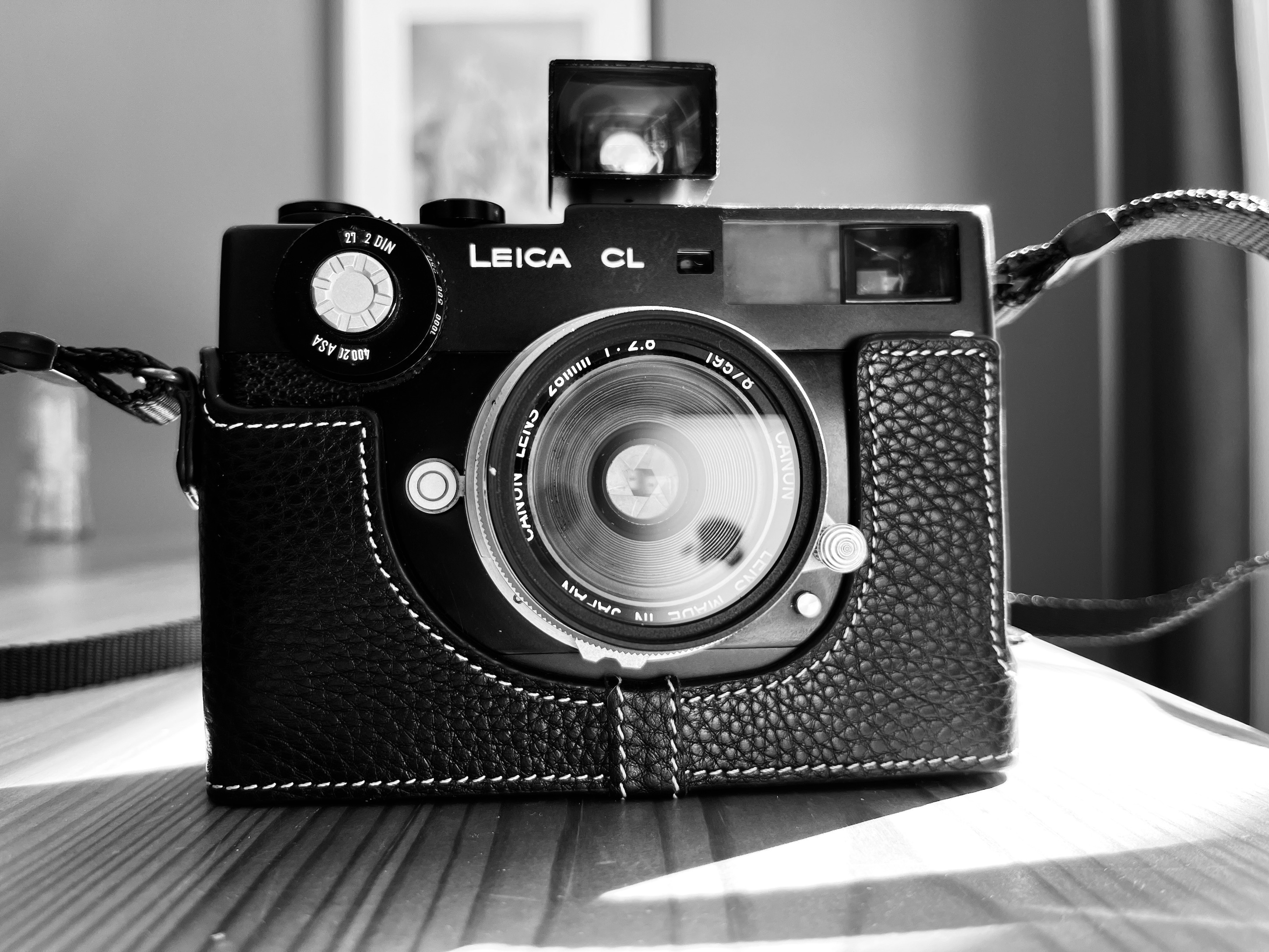

You won't find a Plaubel Makina 67/670 for under $1k. A Leica CL would be a fine option as it's relatively low cost, Don Goldberg has repair parts, & you have access to a variety of both screw mount and M lenses.....even fine modern ones from Voigtlander and other manufacturers. & it the meter is approximately a spotmeter.
As far as small size, I also use a Rolleiflex or a Perkeo ll folder.....both have great lenses. While Tgrain films are sharp, medium format films advantage is in the negative size. Once you start talking interchangeable lenses.....medium format cameras are either expensive (e.g. Mamiya 6) or bulky (Pentax & Mamiya 645). You can't have it all.
