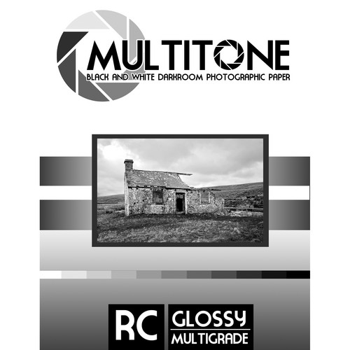

I've been happy with Multitone from B&H as well as Photo Wearhouse's house band. 50 sheets is like $65.00 + shipping.

I don't think anyone but Harman, Foma and Adox makes RC paper (house brands are probably made by one of them), right ? Those are our choices...

I'm not ready to try toning, but that warmtone you recommended Matt looks interesting. Here in the US it's $30+ for 10. 100 sheets would cost $300 plus tax and shipping. Not that pricey really for good, largish paper.
50 sheets of the Multitone for $65 + shipping is pretty amazing. Went to the website and it's now $63 w/ free shipping. Wonder how white the base is? The specs say it has a contrast range of 00-4, while the Ilford MGRC Deluxe Glossy I printed on yesterday was 00-5. I'm guessing that means just what it says, and it would be better suited for well exposed negs? Or something. I like bright whites and deep blacks.

Buy a box of 5X7 and a box of Photo Wearhouse house brand 5X7, print a negative you printed in the past and use that as reference, print grade 2 to 4, adjust your developer dilution until you find a combo you like, then get the 11X14.
So is this paper the cheapest there is i.e. it beats the price of Ilford, Foma or Adox? If its from B&H, does it have the money to contract any of these companies to make its own paper called MULTITONE, assuming it is made to a different formula from any of Foma's Adox' or Ilford papers?
Or might it be that it is exactly the same paper as is currently made by one of the three above and B&H has been able to sell it cheaper - somehow?
If it is the same paper then presumably it has been able to buy it at a price that gives the maker a profit as well as B&H a profit or it may be that the B&H price is a break-even one or even a loss leader?
Lots of questions. Any answers?

There only a handful of paper manufactures, (by a handful 2 maybe 3) brand papers are made by one or the other Harmon or Foma, but who knows who else make make paper to order. I would hazard to guess that Adorama, B&H and PW place a large order, PW might package as well. Now that the UK is no longer in the EU we will know either made in the UK or EU.
