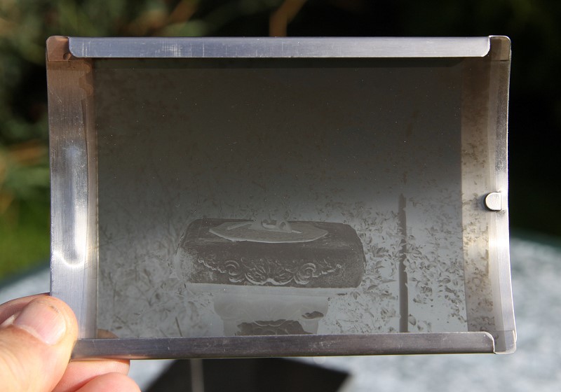

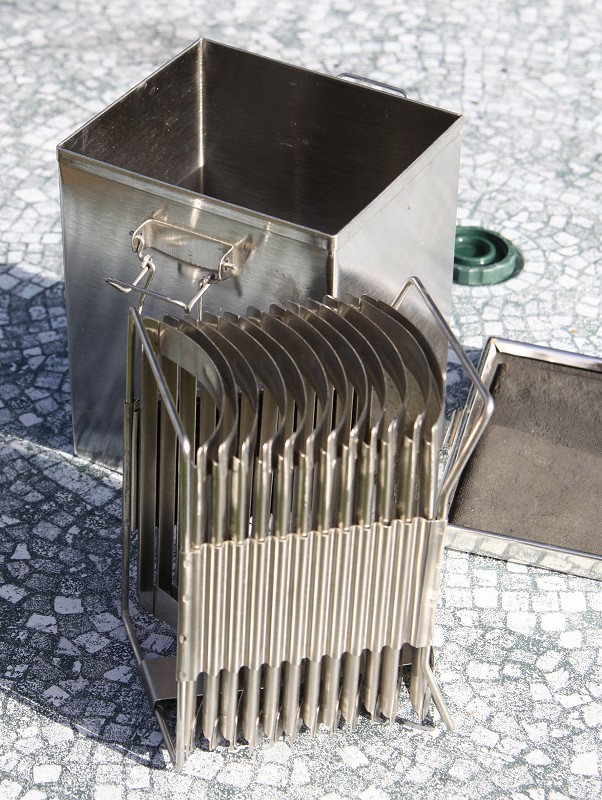

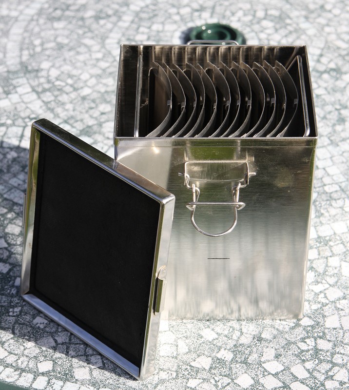

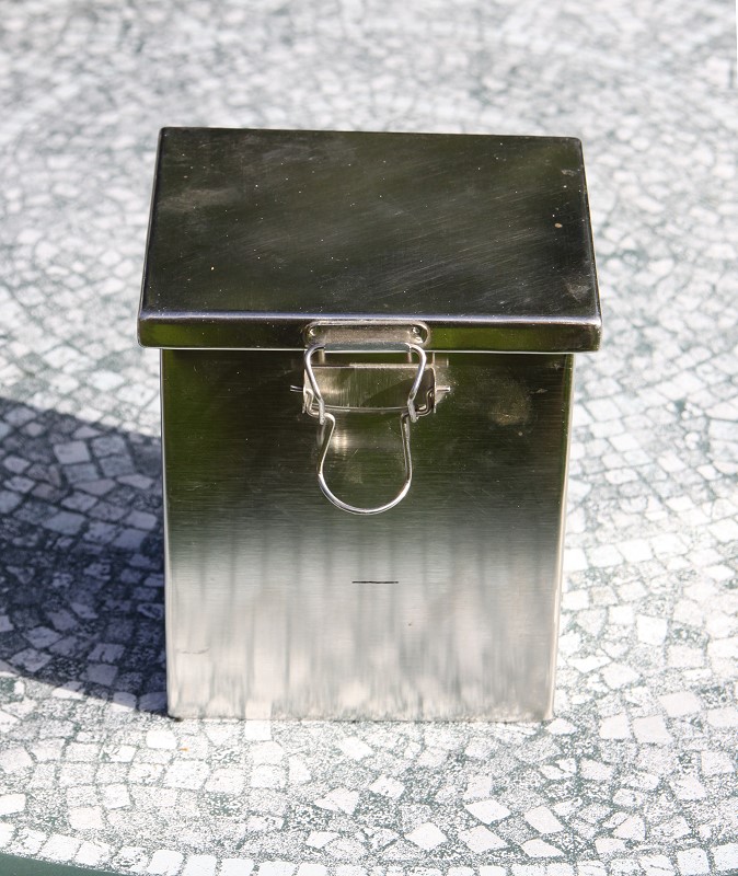

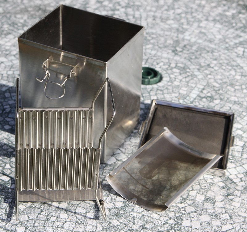

Look for a Dallan processing tank, made by David Allan in the UK. I don't want to sell my Dallan 5x4 sheet film tank, it's stainless steel has a small cage and takes a dozen sheets each sitting in individual holders.

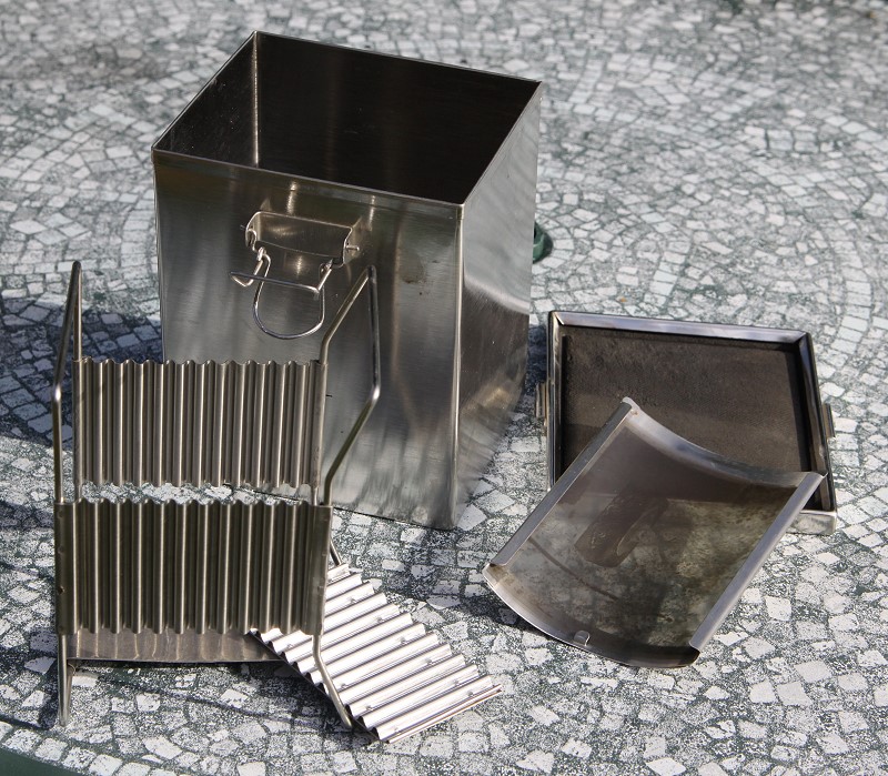

Note the inserts are upside down so film could fall out. . . .
This tank takes plates or cut film, note the spacer adapter alondside the cage.
I think this may be an approach that could be used for largerfilm sizes.
Ian

I should add that most Dalan tanks were for glass plates and often for daylight use with a cap and bit with a light baffle to fill on the side at the top, and a tap at the bottom of the other side to empty the tank. Dacvid Allan (the company) were around from 1868 until about 1960, in the eraly 60's Britain went into a depression and a lot of old established photo companies disappeared.
They used this corragated metal approach early on for rack holders for plate developing and laso drying. It's quite a nice idea and I'm sure film holders in various sizes similar to the last image aboe could be made very easily in either plastic or metal. I think you could make a holder to use two different formats, say 7x5 and 10x8, although for 5x4 and 7x5 would be easier. I'm thinking look at the cage and have the corrugated bit on all 4 sides, so the 5x4 fit as above and the 7x5 would fit at 90 degrees, obviously you'd need to fill to a different hight for the large size.
Ian

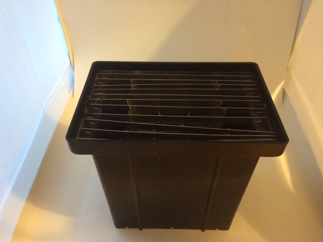

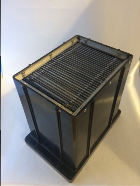

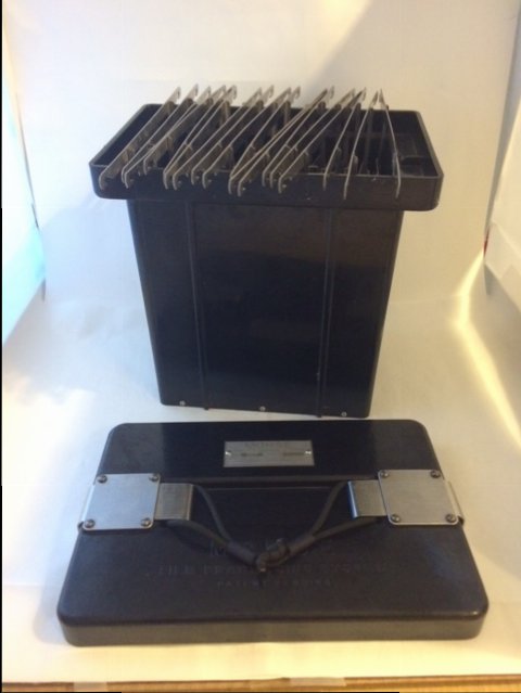

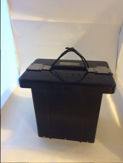

The "Morse" Processing System", I found this years ago. I am looking for the tanks that came with it, misplaced since i moved
When I find them I will put it up for sale. The Tank "Basket" can be used in daylight it is submerged into Developer then agitated like using hangers and hard rubber tanks,
withdrawn, drained, then the same for stop fix etc.It has a baffle on the bottom that somehow allows chemistry to drain and not expose film. holds 10 or 12 4x5 hangers.
has anyone seen or heard of this? only morse system I have seen is for Cine film
see photos

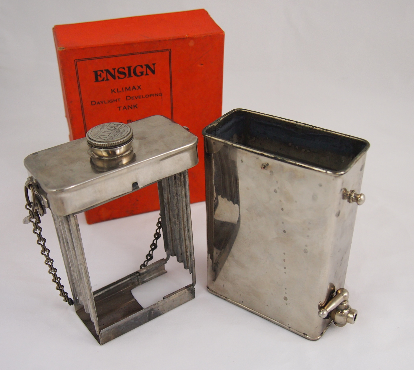

I have the quarter plate Houghton Victo, quarter plate Houghton King enlarger, Ensign safelights - 2 glass to take standard bulbs, i candle powered, to go withnthat tank :D I could have a complete early 1900's Houghton darkroom. I have the 3½x2½ version of the Klimax tank.
Ensign is Houghton's main trade name and they owned a number of companies, by 1910 they had a large factory in Walthamstow, the buildings covering 2.5 acres.
Klimax was a name used by Butcher for cameras, tanks, printing frames, printing boxes etc. Butcher manufactured some items for Houghtons and both companies formed part of British Photographic Industries Ltd registered in 1915, but they already had a joint Houghton Butche Manufacturing Co, Houghton and Butcher traded under their own names despite joint ownership until merging into Houghton Butcher Manufacturing Co in 1926.
There's an important US link, a major shareholder in BPI was Lord Astor and his family, born in the US & moving to the UK at the age of 5, he owned the Times newspaper, was a banker, politician etc etc. He was probably behind Houghton establishing an Indian subsidiary company as he was Aide de Camp to the Viceroy of India j before WWI.
