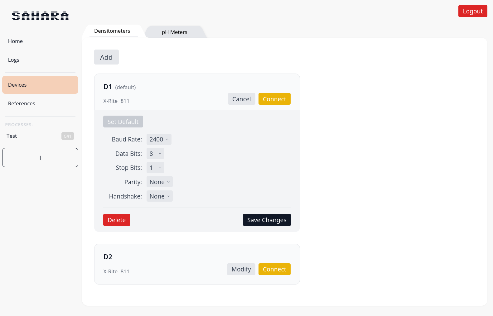

Send me a pm! We are looking for testers for a program called Sahara to solve just this problem. Huge fan of Oasis, many labs I work for still use it daily but I always wished for some modifications which were not possible due to what I assume are the costs of maintaining legacy software. Our tool has all the functions of the standard Oasis but the models are exposed to the user so you can really do whatever you want (custom strip definitions, define your own graph fields with whatever math you like, process definitions) the list goes on...
Here are some photos from an early gui, it is sort of like the old Kodak Colorwatch system based on Technet but instead of us interpreting the results for you we give you an interface to organize information and build knowledge related to your processes. We do hope to eventually partner with chemical manufactures to be able to provide a more granular level of support but for now the value (besides the obvious ability of having a small window into what your process is doing) is primarily in the interface, the flexibility of the underlying models and export functions (reports for marketing etc...)
It is based on the webserial api which means it is OS agnostic but most importantly we will be actively supporting it along with the legacy densitometers required to run a program like this. Currently we are aiming for a market which would be interested in purchasing a package on a subscription basis (leasing densitometers, offering overall QC support these sort of things) but we would really like to see QC more widely adopted worldwide so we are open to ideas.
The beta is geared towards people with X-Rite, Barbieri or similar serial densitometers. I am winding down a long work contract now which will free time up to get this ready, support some usb based densitometers and some spectrophotometers (we will have a webclient and a Windows / Mac client) and start marketing etc... We would appreciate any input as we navigate these early months.

Way to go. Great to see you here. :smile: BTW do you also plan to track specific gravity in Sahara?
