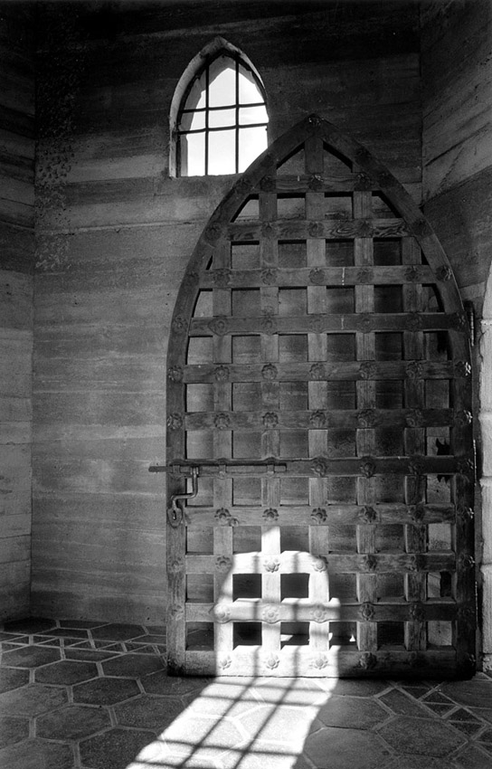

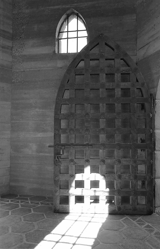

Continuing the "castle" theme of this thread, here's an example of a scene that had dramatic lighting in real life, but resulted in a straight print that was kinda disappointing at first. Often, I can get a straight print that I'm happy with, with little to no manipulation needed once I decide what grade to print it.
My priority here was to expose the negative for the shadows In the upper areas, as I wanted to try to retain the texture and detail in the walls, but I was concerned about the shaft of light hitting the floor and door and trying to retain some detail in that area.
After making some straight prints at grade 2 and 3, I let them languish for a few weeks, not sure what to do to get a print that I was excited about. Once I was in a better state of mind, I decided to try some split-grade burning and dodging and play around with higher grades than I usually would.
The final print ended up having a fairly complex burning/dodging scheme, and I used every filter from a #00 up to #5. Probably took almost a month to get a version I was happy with.
