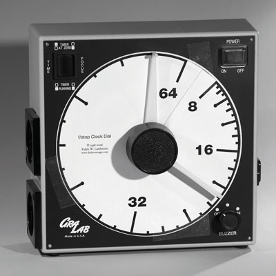

What are you doing? Your GraLab 300 is the best processing timer I've ever used. It beats any digital timer hands-down. Easily set and easily changed (even mid-stream). They can be operated single-handedly. You can see (and read) it from any distance and in the dark, and they can switch up to 600W of equipment (Jobo). You can even turn them into an f/stop timer (see picture attached). They are great timers. Don't do it!
