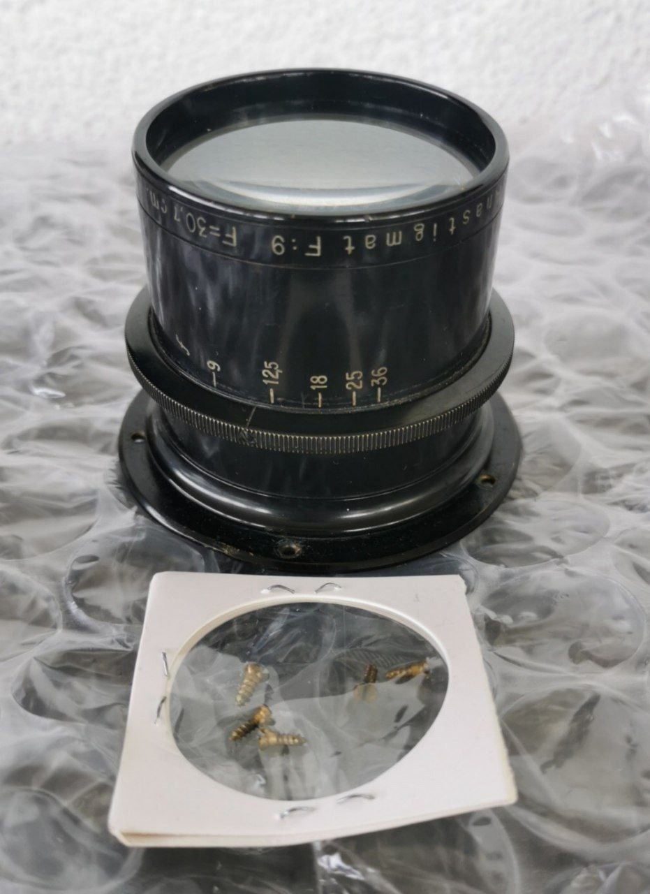

Purchased a rare lens Busch glaukar 307mm/f9, presumably it's a triplet. Have searched the internet but can't find any information. I have a glaukar 140mm/f3.1 but it is from a different line.
Does anyone know what this is?
What do the numbers 1 and 2 on the ring mean?

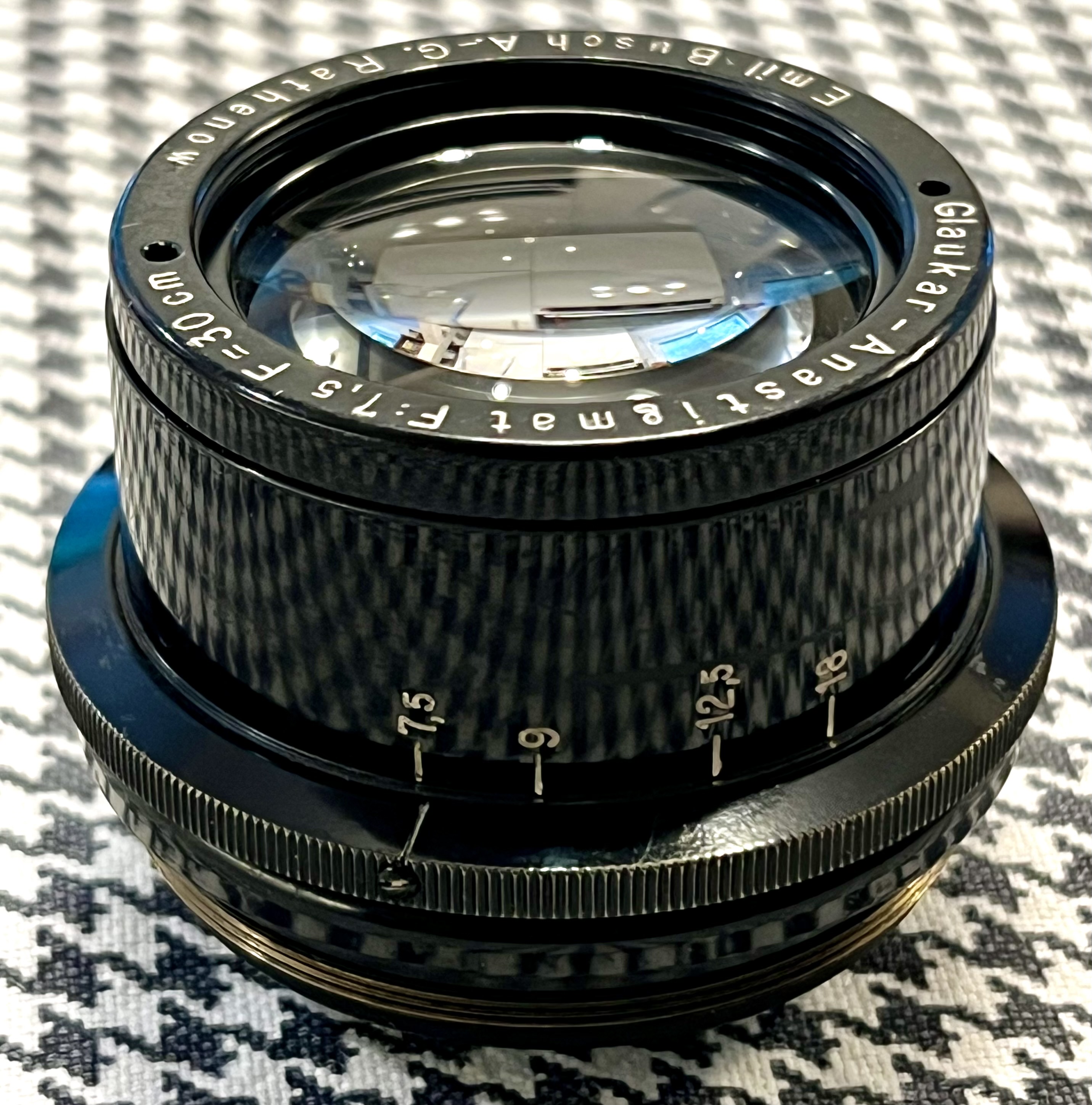

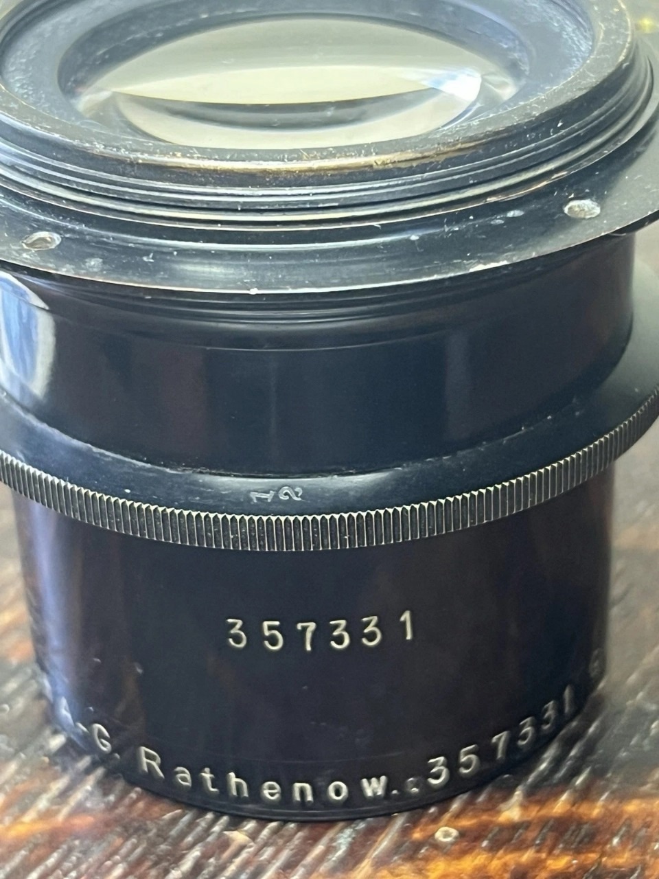

It’s a slow triplet supposingly for technical applications - repro work.
Here is another one in similar focal lenght but a bit faster - f/7.5 with serial 353132.
Weirdly enough mine has only four f stop positions.
Have no clue what 12 marking means on your specimen.

Wow, interesting, but 300mm instead of 307mm
Can it be used for portraits or not? I have a range of iso values: 1-200.

It’s not THAT venerable fast Glaukar, but sure you can use it for portraiture, desirably on 4x5 or smaller formats.
Vaidotas
Feb 9, 2019
90
Vilnius
Consider this lens as Cooke series V (f/8) substitute with similar coverage. That might be 8x10 inch with generous movements.
