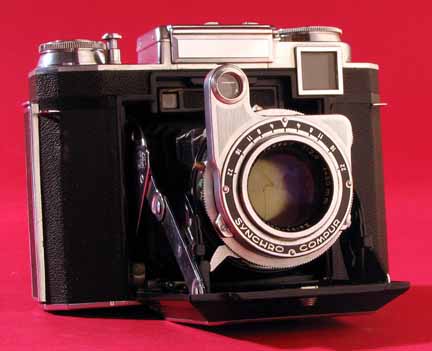

My favorite for a pocketable walk around camera is my Zeiss Ikon Super Ikonta BX. Built in range finder, meter (although the meter doesn't work), 6x6 format, very sharp negatives. Heavy, not a plastic machine.
ZeissSuperBx_003_jpg.htm
