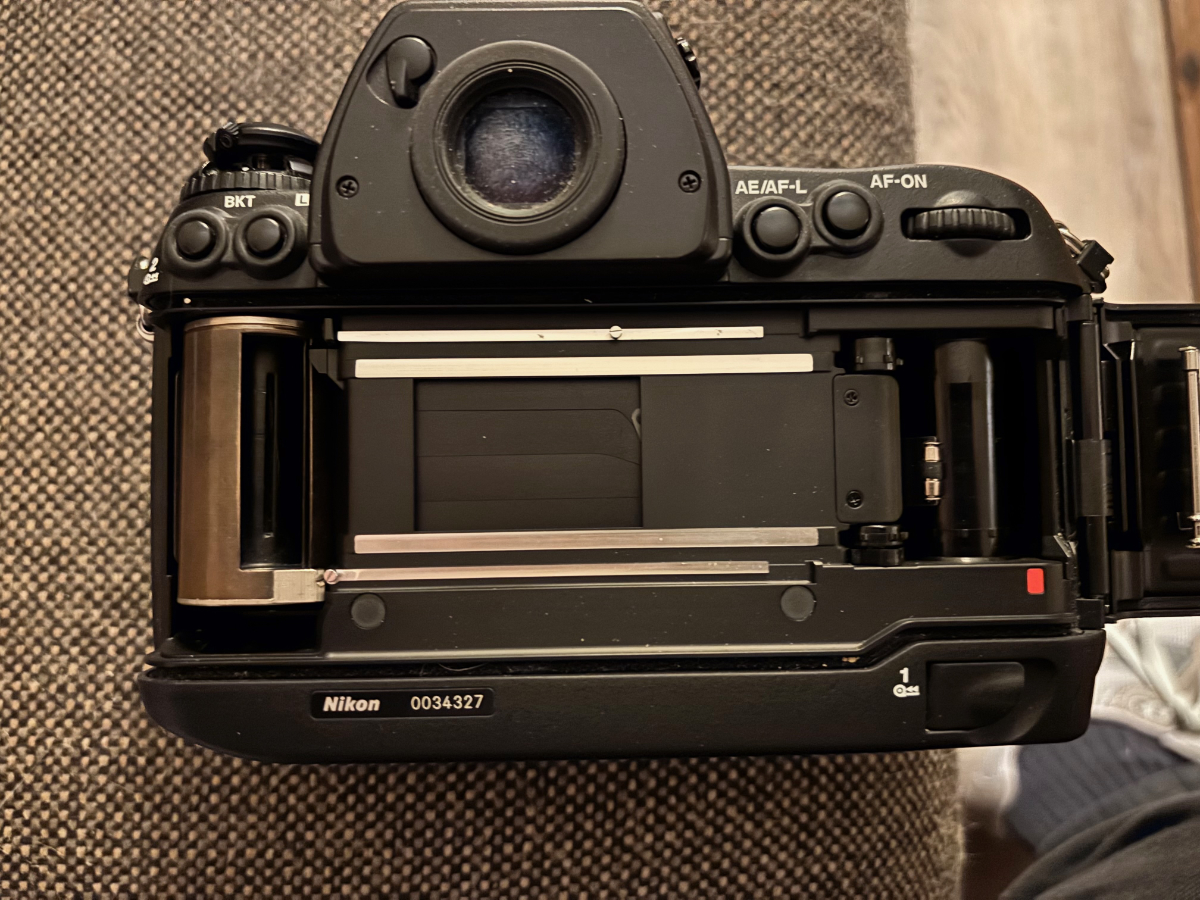

My personal experience is that a S-W will not work in a Barnack Leica or a Nikon F but it will work in a Nikon F6. I do not have a M Leica but, again based on my experience, if it does not have a pull-up rewind knob the S-W will not work.
you have tried it in an f6 yourself? do you have one SW cassette or more than one?
Here is my one and only Shirley-Wellard in my F6. The labyrinth is open so you can see the orientation of the cassette. Note that the F6 rewind knob is pushed up by the S-W. This is necessary because the labyrinth is opened and closed by pressing down on the rewind knob, which compresses the springs in the S-W, and turning the knob clockwise to close or counter clockwise to open.
FWIW none of my bulk loaders (Watson 66, Watson 100, Alden 74) will work with the Shirley-Wellard. They can open and close the labyrinth but the S-W spins out of correct alignment when the crank is turned to load the film. The problem is that the part in the loader that keeps the cassette itself from turning does not extend far enough to contact the vestigial bit on the S-W (the shiny bit at the bottom of the S-W in my photo above). And I doubt that one of the Lloyd or similar bulk loaders would work because they have no way to press the end of the S-W. I would like to find a bulk loader that does work with a S-W so I don't have to load it by hand in the dark.
Given the way the thing works, the part that needs to move up and down (the rewind post) does not move up and down in a Leica where the film is put in from the bottom (might work in a Leicaflex). The rewind post moves up and down in back-loading cameras so the cassette can drop out.
