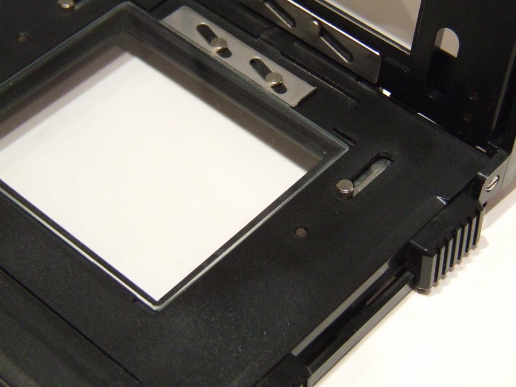

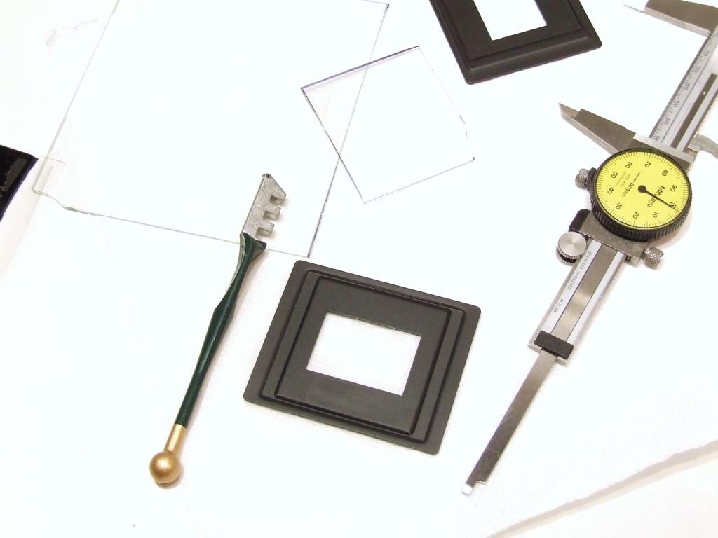

Durst 4x5 AN glass shows up on ebay from time to time. I cut a broken 4x5" piece for my 6x7cm carrier.
