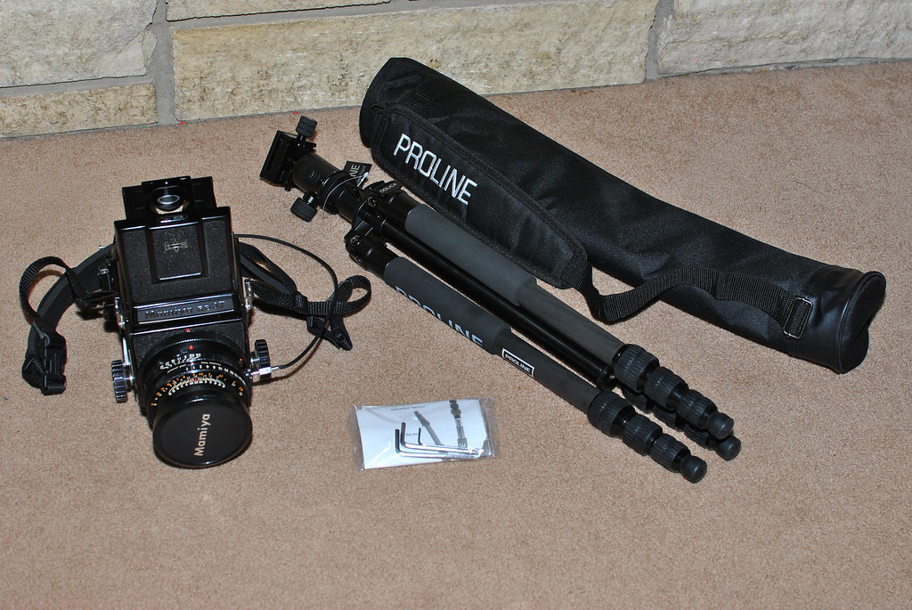

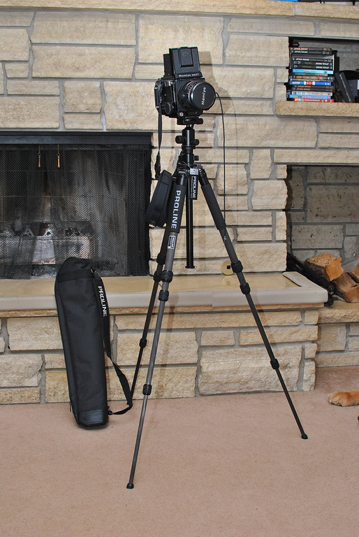

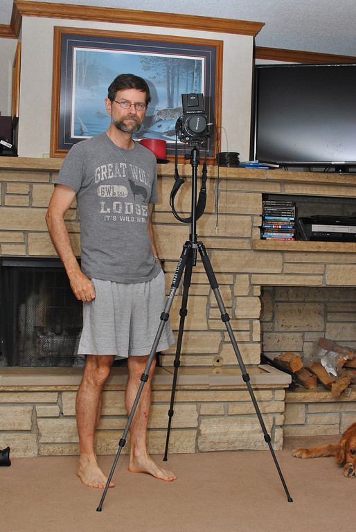

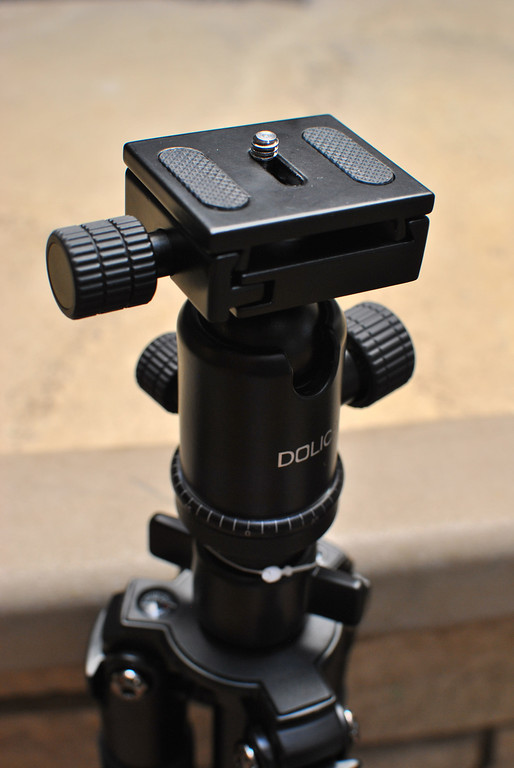

I actually own the tripod and the head. Here are some pics.
Carrying an RB67.
Fully extended. I am 6 foot 2 inches tall.
The kit
Closeup of ball head.
If that ballhead supports a RB securely, I'm impressed. How stable is it with the RB on top and the center post not extended?
Well, it's hard to judge stability. It's certainly not as sturdy as a professional heavyweight aluminum tripod. You could certainly knock it over. That said, it doesn't wobble excessively to me - your opinion may vary. There's a hook on the bottom of the center column so you can add weight if you want for increased stability. One item of note: the total spread of the tripod seems just a bit narrower than I would like for a heavy camera. That may be due to the relative narrowness of the bottom leg segment. It does seem to slightly, very slightly, bow outward with a heavy camera. I don't think it's a cause for concern with what I shoot but it may be an issue for others.
I don't think there's a better $100 or so tripod out there that weighs under 4 pounds and supports 13 pounds max.
