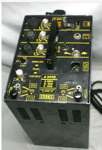

I've got the 1200 and 2400WS Balcar power packs and I just fried the receiver of my Micnova radio slave plugging into it to see if it would trigger it. My 2400WS pack is similar to this one. Screen Shot 2014-09-14 at 9.15.14 PM.png
I'm wondering if there is a radio slave made today that can handle the voltage from old school power packs like these? I can use a synch cord plugged into a Wein safe synch, as I'm using a Canon 6D, but I'd prefer going wireless.

I've got the 1200 and 2400WS Balcar power packs and I just fried the receiver of my Micnova radio slave plugging into it to see if it would trigger it. My 2400WS pack is similar to this one. View attachment 1145

Well as long as it not fried your camera ,the slave did its job and saved you a lot of money:smile:.Calumet made a Canon -dedicated unitbut Calumet is no more.I'd go for one of theselow-cost chinese unitsor use a light slave triggered by your pop-up flash

Some kind soul took pity on me and sent me an extension cord to run my 1200WS pack.
Excited I headed over to the rental studio I keep my gear at. I plugged in the unit, everything switched to run on 220, and the modeling light and flash worked. The fan was making some odd noise.
I let the unit run without firing for a long time at first as it had not been used in over 2 years. After testing the flash, and it fired, I let it run with the modeling light on but it started smoking badly and I shut the thing down. Seems the fan in that head is now cooked as it won't run on my 2400WS pack either but the flash tube will fire. I just don't think it's a good idea to run it without a fan even with no modeling light.
So I'm kinda stuck till I can find someone who is willing to work on this ancient thing.
