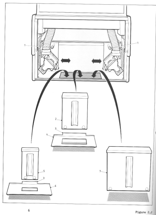

Actually I would like to cover 6x4,5 and 6x6 negatives,. My 35mm box is 4cm x 5,5cm and 10,5cm high. I found 35mm, 6x7 and 4x5" comparison (Ilford Operating Manual):

Don't forget the plate the 6x7 box sits on
I personally use the 4x5 box with a 4x5 glass neg holder and framing shutters for all formats so maybe that would work for you
the MG500 head is so bright that I often still have to stop down the lens a bit just to give myself a chance to dodge a bit
the more efficient 35 or 67 mixing boxes would just compound thing further
robin

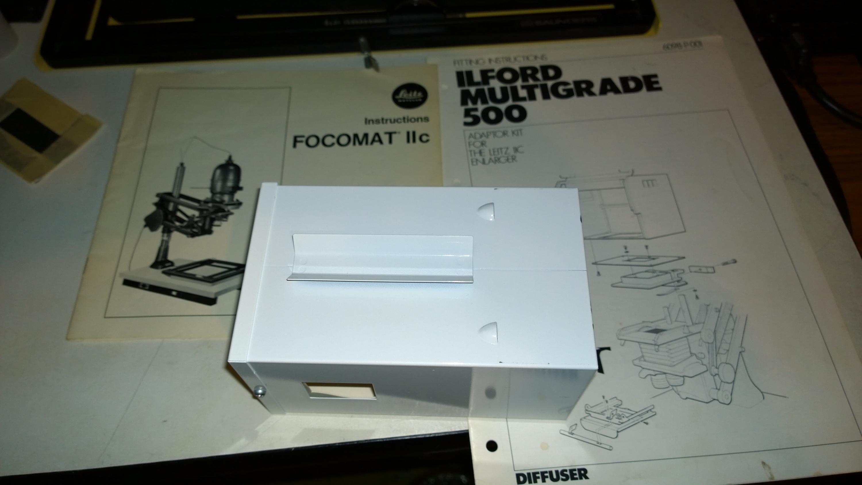

George, I have a question: does your manual also shows a light mixing box with a very small drop from the dimples? i make a comparison photo:
The Leitz adaptor manual doesn't have any pictures of the mixing boxes.:sad:
Here's a link. The second paragraph mentions there are two versions; one for the Diffuser set up (which I have) and one that retains the condensers. I suspect the mixing boxes are different. In this (there was a url link here which no longer exists) there are pictures of other boxes. They seem to vary for each enlarger, the other box I have is for a Beseler 45 and it is almost the same except the drop is 45mm. If you have the 35mm box I would expect the drop to the same for the 6x7 box.

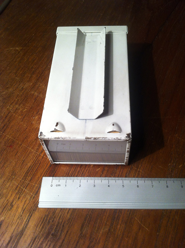

Here's my box (4mm drop):
