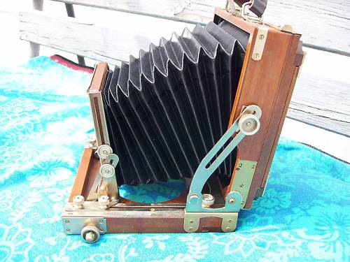

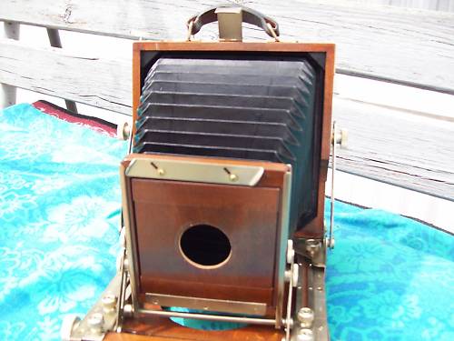

I have an old (1946) Crown View for sale in the classifieds here. It is light and in good shape for it's age and has a fair amount of movements. I used it for back packing in the Sierras for many years but can no longer hike like that. Take a look at the photos.
