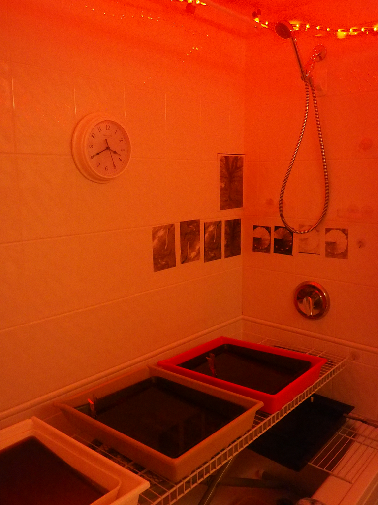

Have you considered an analog clock with a sweep second hand, positioned where your room safelight illuminates it?

This is what I am doing but my eyes are aging faster than the safelights which are dim.
Sounds familiar - but also sounds like a Country music lyric too! :smile:
My LED rope light safelight is so bright that that isn't an issue for me - it is even brighter than this appears:

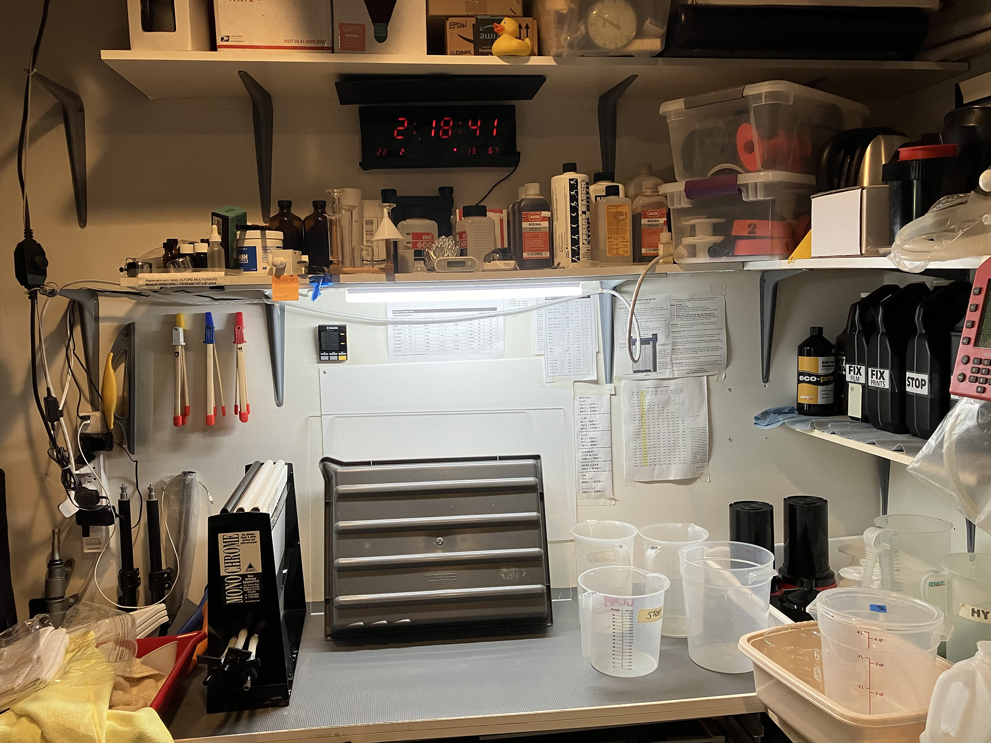

@cowanw I had the same requirements you do, and also wanted a countdown timer that could countdown seconds and beep periodically. I ended up building something from a couple of 7-segment displays driven by TM1637 modules and an ESP8266 microcontroller. It links up with WiFi and syncs the clock with NTP so I never have to bother setting it. Not as easy as pulling something off the shelf of course, but it was a fun project and the result has been serving me very well for several years now.
