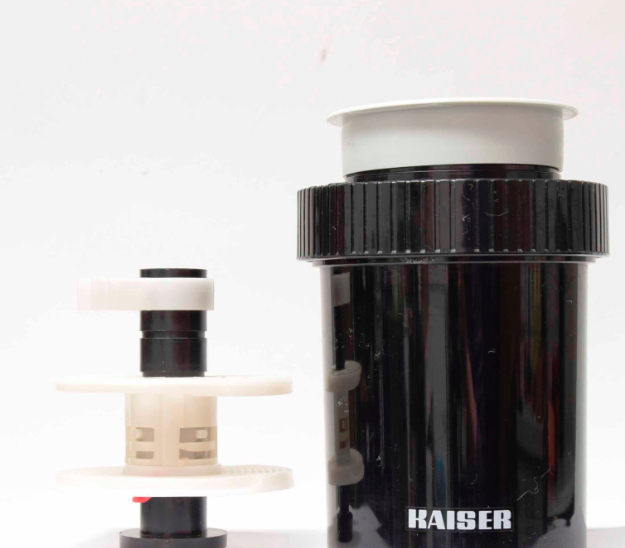

However, Paterson System 4 tank requires ~600ml for 2 rolls. I have another tank, an old Kaiser which is not sold any more with one reel which does work with 500ml, but the reel shaft has no "tooth" for agitation stick (don't know how that thing is called?). I thought of improvising something, but not sure if using either CA or epoxy glue is a good idea (possible contamination).

Or get another reel for kaiser and hack it to be able to use agitation stick. It's actually a pretty good tank and it has served me for a number of years. Sadly not available any more.
This is how they look (image from ebay).
