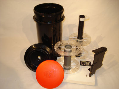

Many people use the Jobo tanks with the rotary systems for 5x4, I'm not sure of the tank no's. However I use an older inversion 2000 series tank (pre-rotatry) that takes two spirals of 6 sheets each and this needs 1 litre of chemistry per spiral. I have used if for E6 many times in the past.

Yes, old Jobo 2000 tank and 2021 reel use 1l of chemistry. Those pop up on german 'bay quite regularly and are a tad cheaper than new style reels. Watch out to get correct size reel, because they are not adjustable. Most of them are available in 9x12cm size.
Two-reel setup (which Ian has) looks like this:
Loading device is of no great use IMHO.
