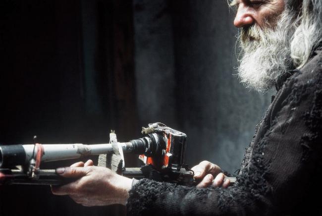

Does anyone know what focal length Tichy's home made lenses were? They look about 135mm, not hugely long.
darkosaric
darkosaric
Apr 15, 2008
4,568
Hamburg, DE
This looks much longer than 135mm to me:
