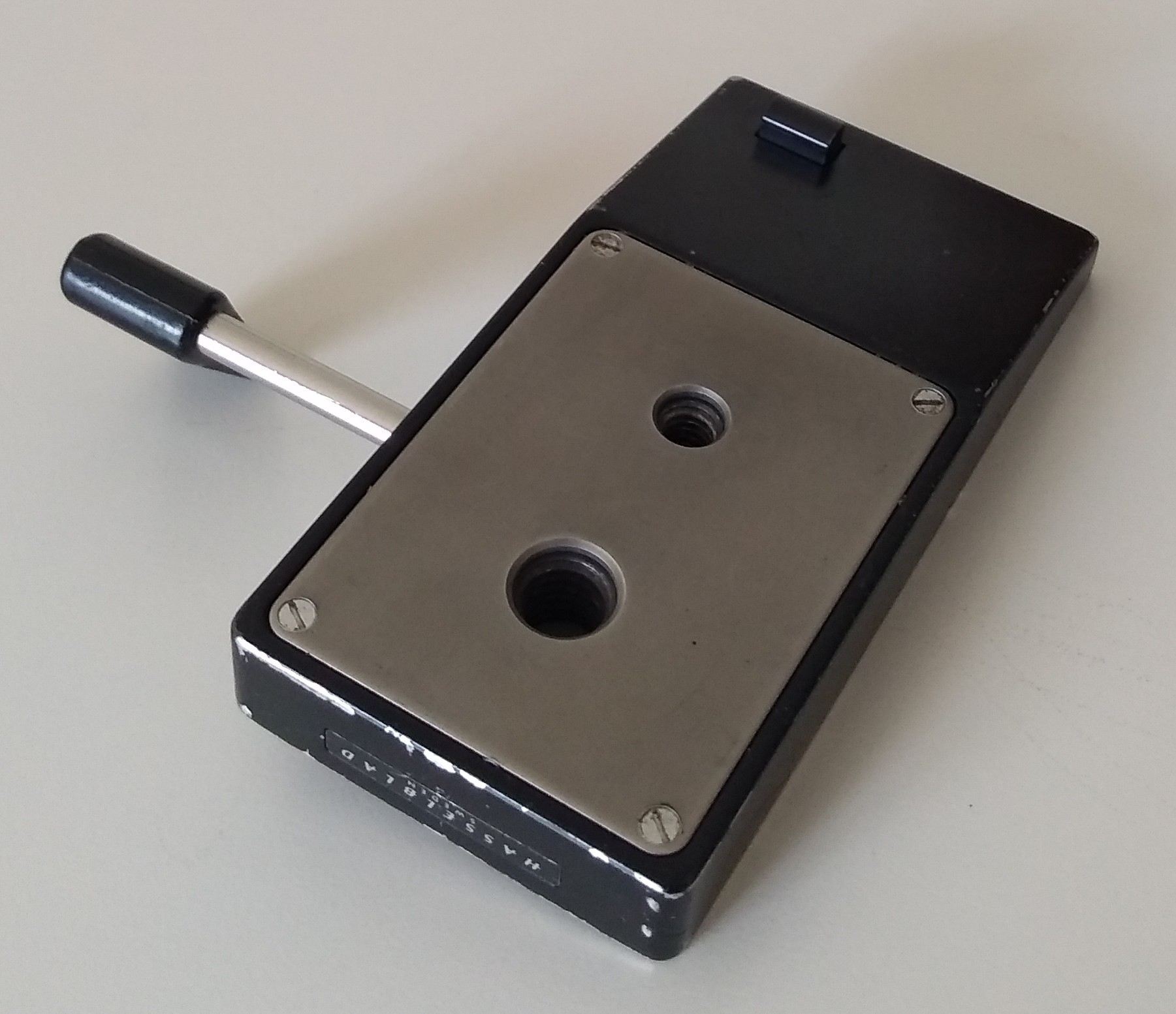

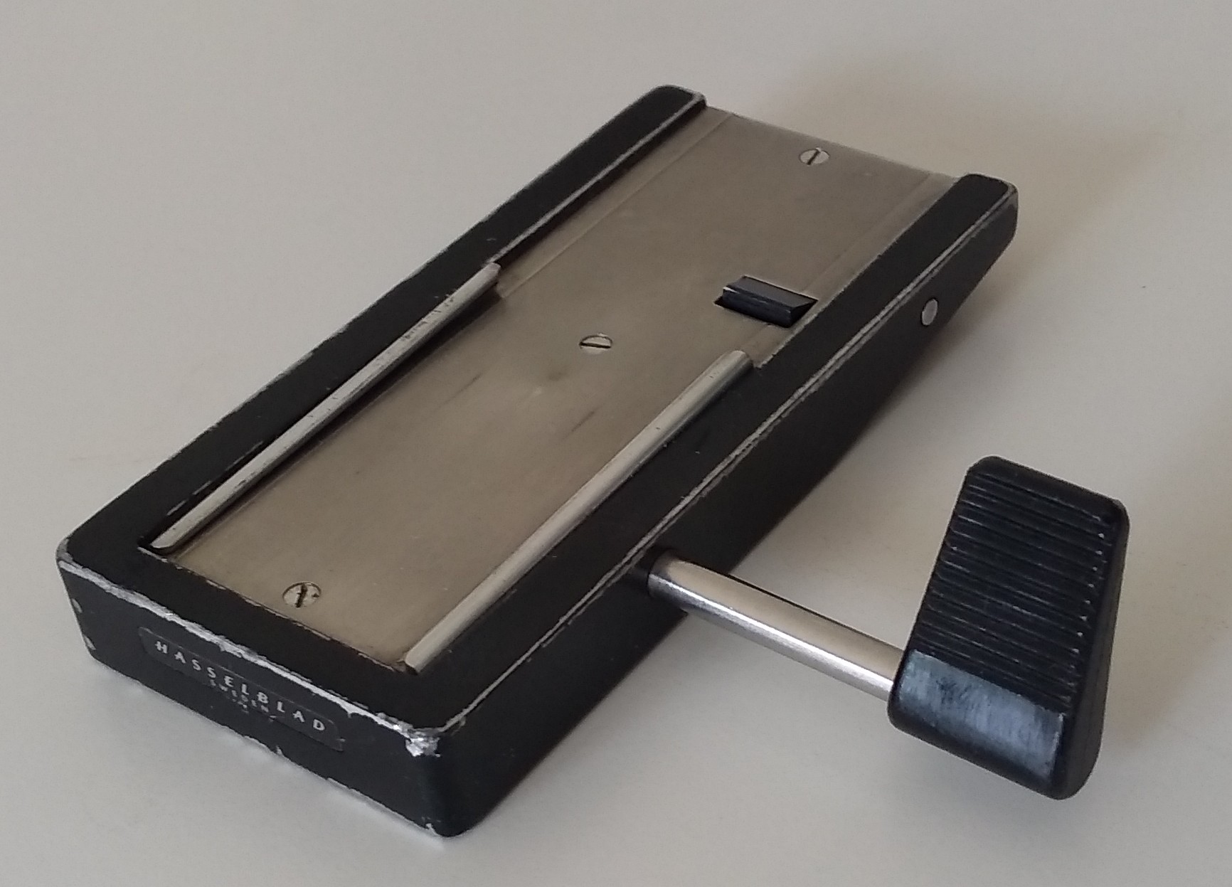

I have no idea which one I've got:

That’s the “long” version. Just curious ... do you remember what you paid for it? And what kind of tripod head do you use it with?
All of mine came off eBay for about $35. To get best price it takes a bit of patience and diligent monitoring.
All of them fully support the camera and lens. The long is easier to mount the camera. That’s the biggest difference. The longer tail really doesn’t translate into more support. The oldest version work to but seem too have softer threads in the socket that can strip.
