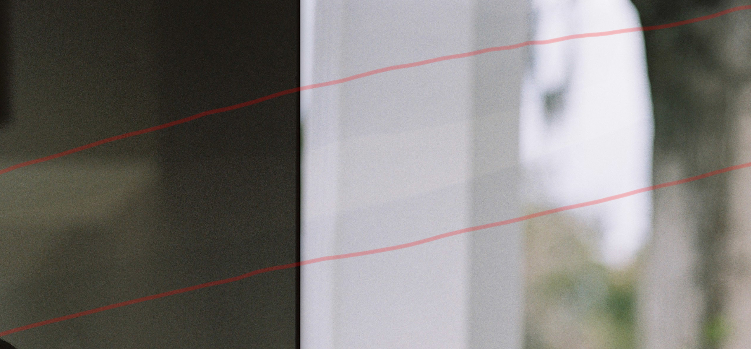

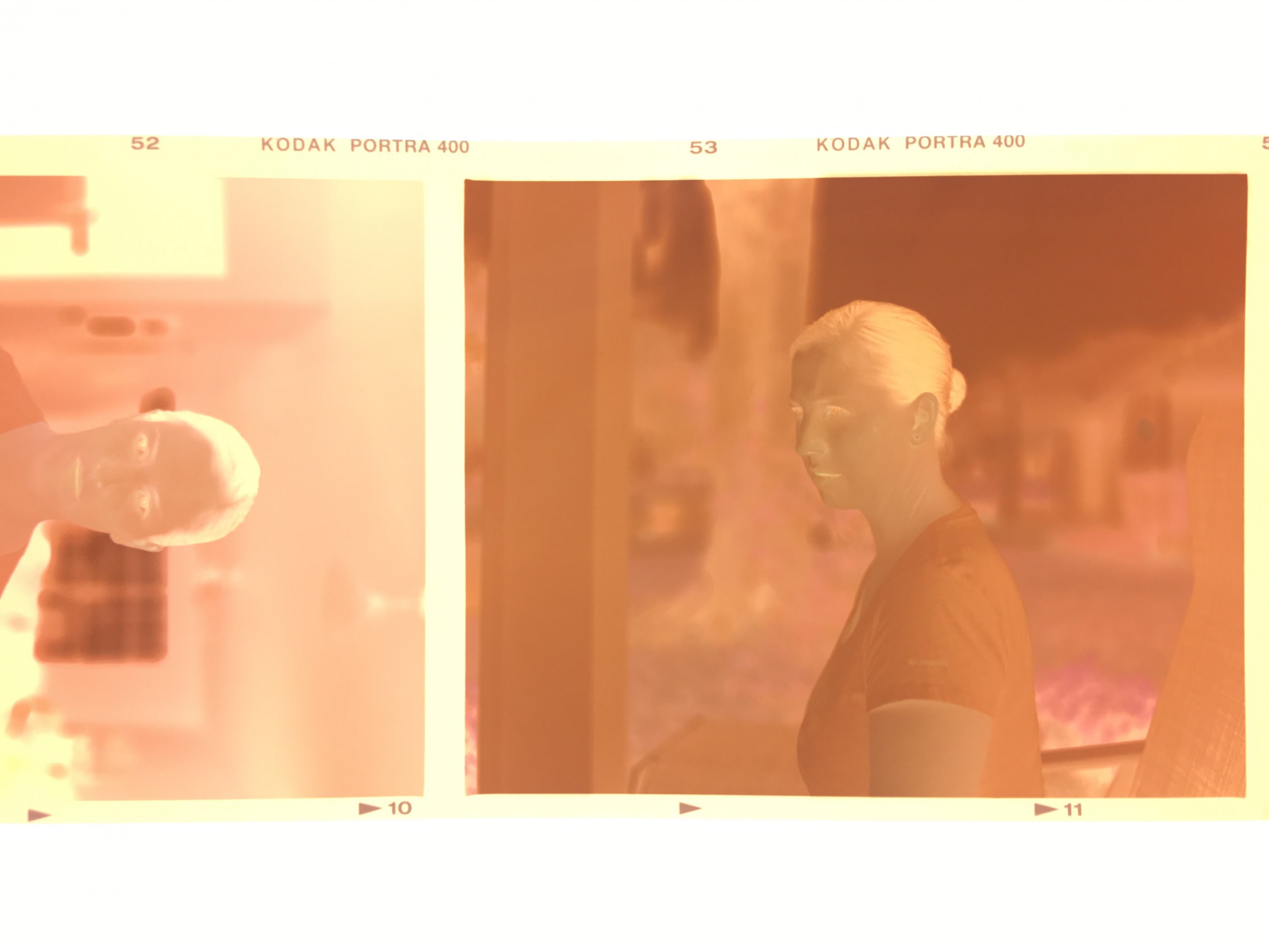

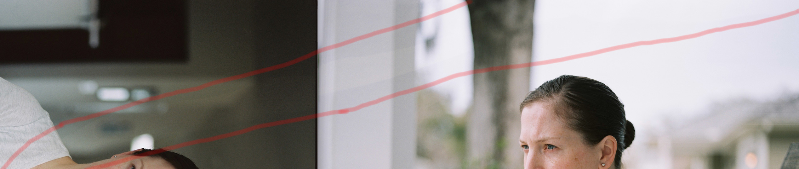

I got this weird streak between two frames. I'm using a Jobo and a 2523 tank, with two 120 rolls side by side in the same reel. This streak happened on the second loaded roll. Second to last frame, which means that it was right in the middle of the reel fully submerged in developer.
I'm using fresh developer and I'm reusing my bleach and fixer, so far they have 8 rolls in them.
The streak is on the negative itself. I tried to take a picture but it's hard to have it show, but it's there, you can see it easily and it comes from the edge of the negative.
I washed the tank and reel with a 50/50 household bleach and water and rinsed both very well just a couple of days ago. Other than that I'm out of ideas.

It does look like a drop of liquid rolled across the emulsion just before you processed it. Seeing how it made a lighter streak whatever it was accelerated the development slightly. Possibly a drop of water or developer got on it.

About your initial problem with the streak: If you look at the C-41 kit instructions, you will see that a few dozen extra seconds in CD mean a lot more development. How quickly did your switch from CD to bleach go? Any chance there was some pause, giving a thick droplet a chance to develop some more for 10-20 seconds? Pouring CD from film tanks takes time, and if you do it too slowly and carefully, there's a non-trivial chance that you do more harm than good.

It's obviously Portra 400 (see third pic), and most C-41 CDs are interchangeable.
