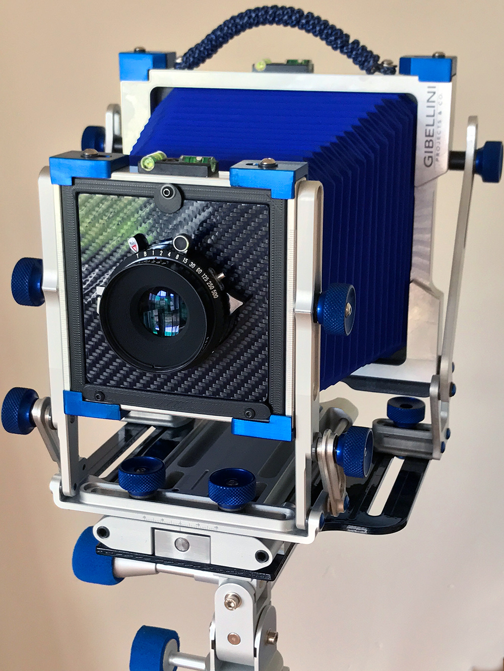

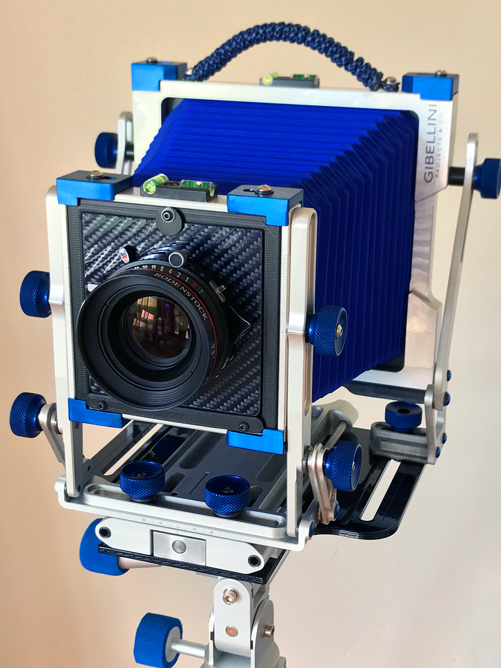

In my opinion, "Long" in 4x5 starts at about 300mm and beyond.
Although not an insignificant change in how the resulting photo will look, 200mm or so is merely a nod and a wink beyond the so called normal perspective of a 150mm "Standard" lens for 4x5. So for the 200mm-ish range, I approach it two ways. I have in Copal-0 a Nikon M 200mm F8 and a Fujinon A 240mm F9. But for low light I use a Sironar S 180mm 5.6 in Copal-1, a pretty spectacular optic and on my Maxwell screen comes within a stop of the actual scene if you took a photo of the back of the camera among it.
So I would say you have to bite the bullet and get a Copal-1 board and go for a nice modern 210mm 5.6. It will feel big compared to a Copal-0 lens like a 135 or 150 5.6 but it's worth it.
Here is the Nikkor M 200mm F8 and the Sironar S 180mm 5.6 on the camera for comparison:
