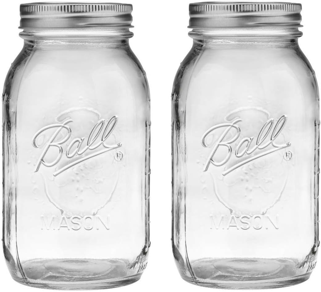

What's a Mason jar, juan or anyone else?
Thanks
pentaxuser
A jar used for canning, like these two:

You can get plastic lids with water tight seals for mason jars. That should stop the corrosion.
I’ve also been testing out Kombucha bottles. The Kombucha we can get at the grocery store comes in 500ml or 1500ml thick clear glass with a somewhat wide mouth. The darkroom is dark even with the door open so I’m not too worried about the clear glass. The caps seem like large soda bottle caps, so I may replace them with large rubber stoppers. I may test aging a few 500ml bottles of XTOL just to get an idea of shelf life in glass. In PET it seems good for up to about a year. Hopefully glass is longer.

Thanks Matt I had never heard of Mason jars and had expected not to be able to find the U.K. equivalent but I did. Initially they look just like any other glass jar with a screwtop lid but then Wikipedia came to my rescue. What makes them different and better for storage is the detachable inner metal ring on the jar to which the lid fits as opposed to the usual glass jar with a very coarse thread in glass

Just another reason to hop over and visit your former colonies while picking up lenses and film. But take warning that English has not been spoken here for years.

Mason jars are just a brand of North American canning jars with screw tops. In Germany, with a bit different lid, these would be Weck jars (with a rubber ring which seals only after boiling the air out, so not excatly useful in our case, but you get the idea...). I guess every corner of the world has something somehow comparable with a long history, some might work while others don't.

I would avoid metal lids for long term developer storage, as corroded metal compounds could be chemically active.
For the OP, D-23 mixed from powder as needed using simple spoon measurement of two ingredients that don't have to be measured precisely might be an option.
D-23 might be fine but the OP is looking for a liquid developer and assuming he were to accept the benefits that D23 confers in terms of simplicity of make-up it would seem we already have a difference of opinion as to the advisability of metal lids due to the danger of the chemical activity of corrosion of said lids
So can I ask what the evidence is that (a) metal corrosion occurs in jars with metal lids that are opened reasonably frequently in normal household conditions?
If it's a serious and likely occurrence then it is right to raise it, possibly, despite his stipulation that he is looking for liquid developers only but if not then we are introducing doubts and uncertainty into what I imagine the OP was hoping to be his reasonably straightforward thread with reasonably certain answers
