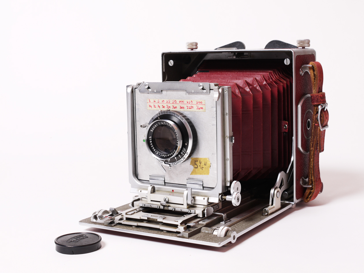

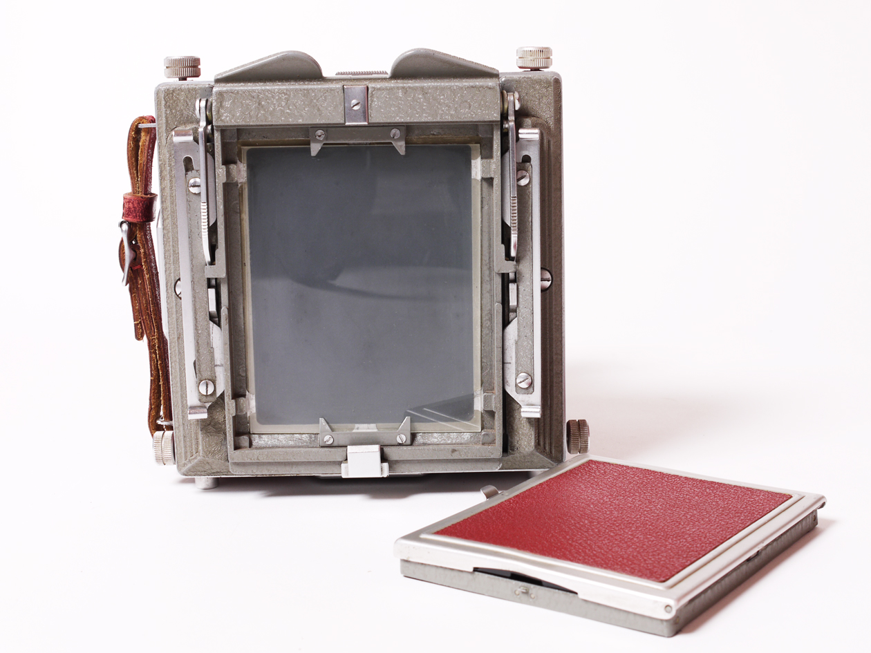

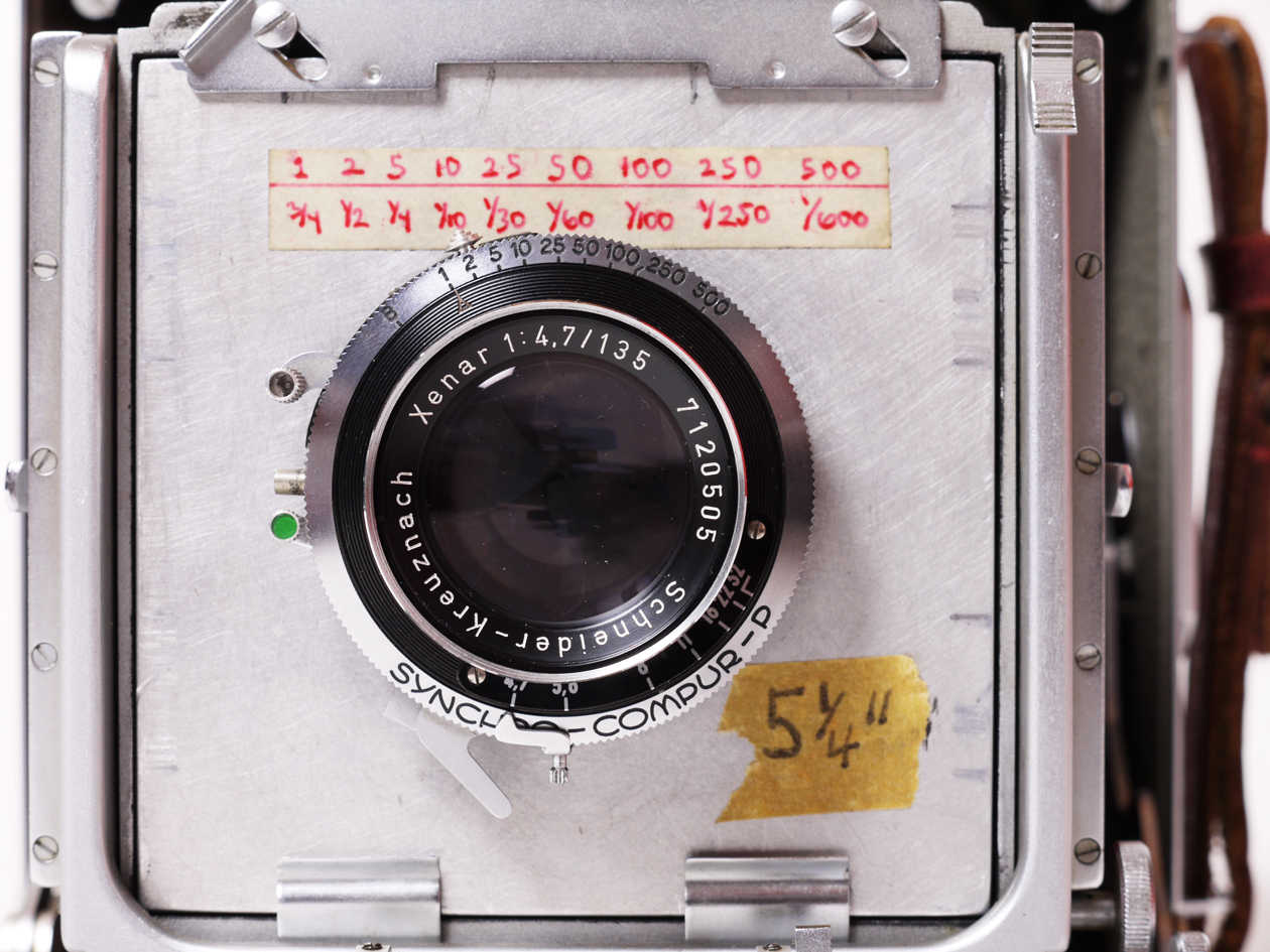

A London Technique 4x5 Field camera. It needs a new bellows. It comes with a Schneider Xenar 135mm lens. It is an all metal 4x5 camera very rugged. It has great bellows extension, once you get a new bellows. Has a fold out ground glass shade. $200.00 + shipping costs.

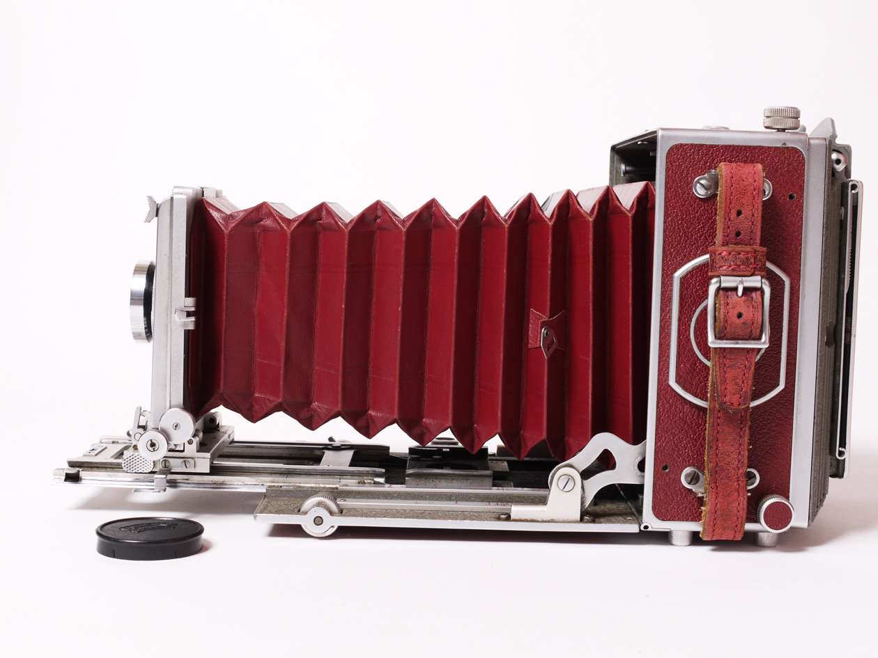

Is the bellows that bad? I don't see any obvious tears or anything. Pinholes can be patched much easier than replacing the whole thing.

okay it is a Micro-Techon London model. I patched the bellows with black tape and it was okay last time I tested it. But who knows if its okay now.

I patched my Tech III with so many patches of gaffer's tape, it's more tape than leather, but it works fine. :wink:
Actually that's not true, but there are more than a half dozen bits of tape here and there.
The MPP is a clone of the Technika, correct? Which Tech is this like? Does it use the same boards?
They were based around the WII Tech's but then evolved but they aren't exact clones. After WWII theBritish Government helped/encourage companies to use German technology as part of War reparations Taylor Taylor Hobson set up Reid to make Leica copies, MPP made cameras based on Lihnof and Rolleicord/flex models.
This is a later model I think a Red MicroTechnical MkV11 so has evolved away from the Linhof's compared to the first versions, MPP's use their own lens boards, they use a cone for WA's (not recessed) so the standard remains on the rear rail.
If I had spare cash I'd snap this camera up immediately, it would sell for at least $600 in the UK and as it has a lens maybe go for $800 (£500) or more.

Ok, for those of us interested in trying out LF (have been at 645 format for quite sometime), and are thus otherwise a neophyte, does this camera actually require a new bellows or would patching be just fine. I'm pretty good mechanically, is replacing bellows a deal or not so hard to do? Another newbie question, what about film holders or whatever it uses...are they needed, does it have 'em, and even dumber question to those of you with experience: how many unexposed negatives do you generally carry when out making photos?

The camera takes standard 4x5 film holders that take 2 sheets per holder. You should be able to pick up these on here real easy and as many as you want. Fixing the bellows is possible. Replacing it is a matter of some screws if you can find one that will fit. Yes it a cheap was to get into 4x5. Let me know. Send me an email at edward@amindseye.com

I'd have to see the bellows in person to have an opinion on it. What I do and is usually recommended is put the camera in a dark room, extend the standards all the way out for maximum bellows extension and remove the lensboard. Then I put a little maglight flashlight with the lens removed, so it's just a bare bulb, down inside the camera/bellows and look all around for leaks. You'll often find them in the corners. These can be patched several ways - gaffer's tape or that goopy plastic rubber repair stuff being the most common. If it's just some in the corners, that's fine, just patch them. Serious tears or a large number of pinholes usually warrant replacement. Mine is old and has probably more than a half dozen bits of gaffer's tape on it - works fine. It's not rocket science, just has to be light tight.
There are people who make replacement bellows, even custom ones, but I don't know much about that.

Oh yes - I have the identical lens, that 135mm Xenar. It's a decent lens to get you started, moderately wide on 4x5. Not much coverage for movements but it's bright and easy to focus and results when stopped down will be just fine. :smile:
