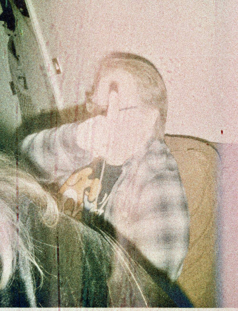

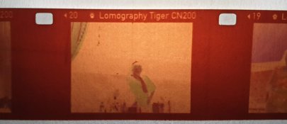

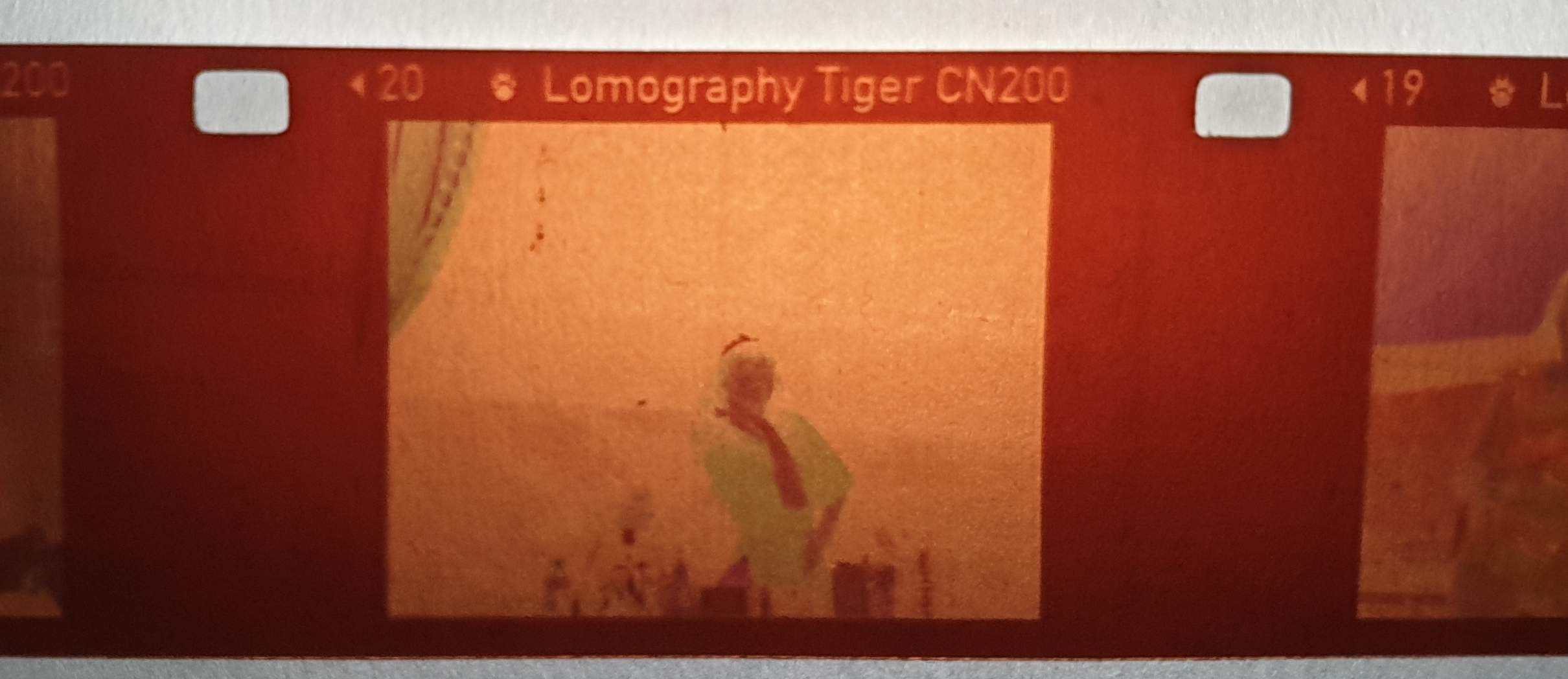

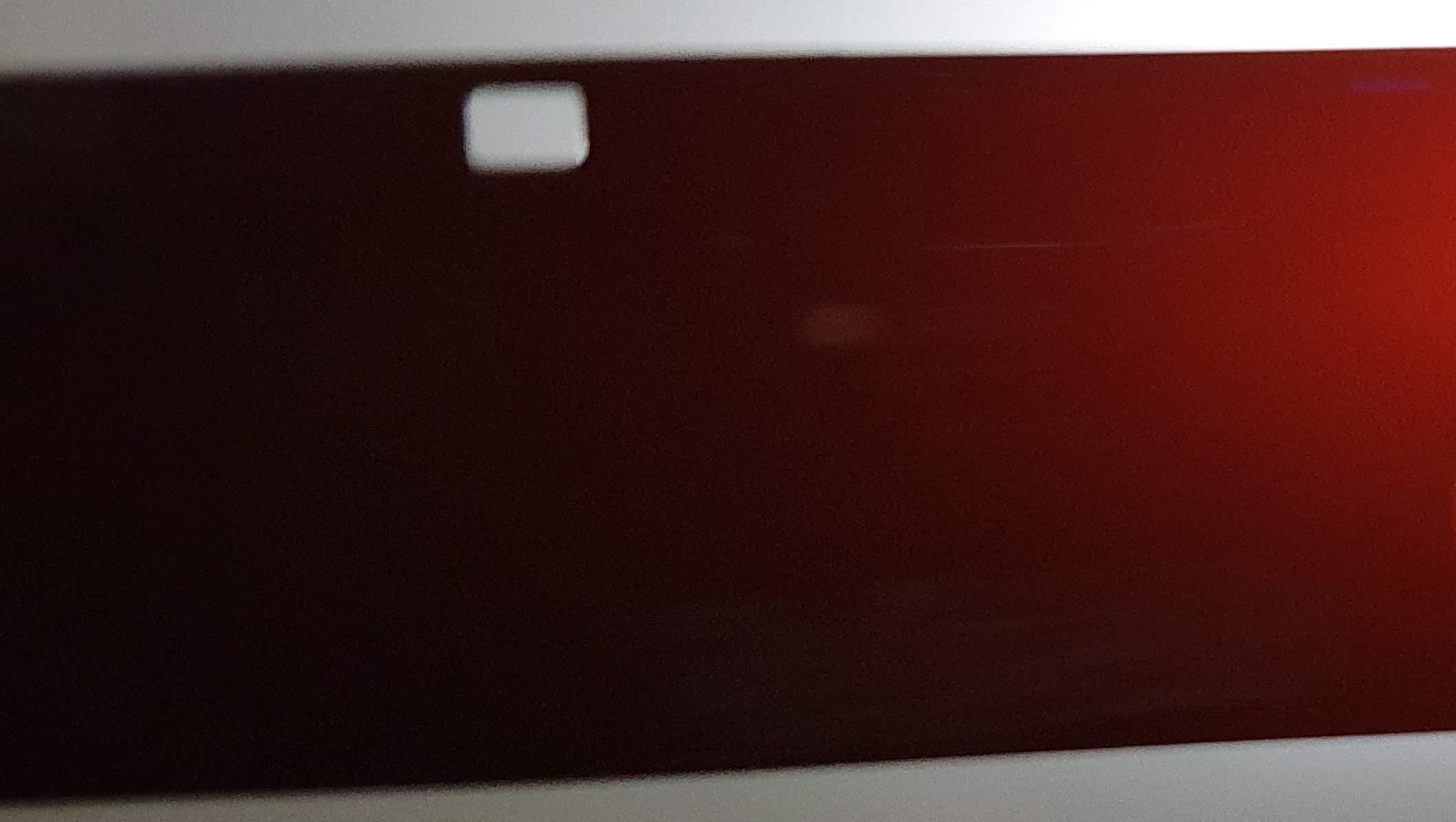

I've successfully used Lomography Tiger 110 format film twice before, in a 70s ITT camera that looks like something out of Star Wars. I used the same camera again over New Year with a fresh, in-date Tiger film and got very odd results.
9 out of 24 exposures were salvageable by the lab, and they are all washed out with what appear to be scratches all over them. The negative strips all look almost uniformally brown with the frame numbers, frames and edge markings not visible. Previous 110 films I used in the 80s and the two Tiger films I shot in 2019 all looked as I expected. Tiger film is not one of Lomography's "special effects" films it is supposed to be a regular C41 colour print film with vibrant colours.
I have attached two scanned pictures from the film and a photo of a negative strip with a photo of a "good" Tiger strip for comparison. The lab I use is busy and always uses fresh chemicals, maintains the machine etc. The lady processing this has been commercially processing colour film for 45 years and suspects a film manufacturing or packaging fault. I had 35mm film developed at the same time which was perfect.
Any ideas what could cause this? I have also written to Lomography to ask them. Has anyone seen anything like this, either with Tiger film or other? Could it be faulty film? Or a camera problem?

Normally the area between the frames should be a lot darker, almost black in colour, and not the brown in your sample photo.
As you have mentioned about the lab in this post and in previous posts, they know what they are doing so I would assume it is not a processing problem. Just out of curiosity, the 110 film was processed in the same machine that 35mm films were processed?
When I look at the image in the negative photo, it appears underexposed. Of course, if it was underdeveloped then it would look similar but as you say the lady has a vast experience of C41 processing so I would go with what she says.
Sorry, I can't be of any better help.
