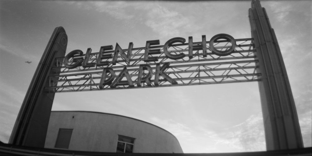

It is modestly sharp in the center, and extremely soft and mushy at the edges:
Being that the lens is plastic, it is also extremely low-contrast. This could possibly count as an upside - the shadow areas had detail in them much further down than I would have expected, but this also contributes to the apparent softness. I would not recommend this lens for anything other than lo-fi enthusiasts.

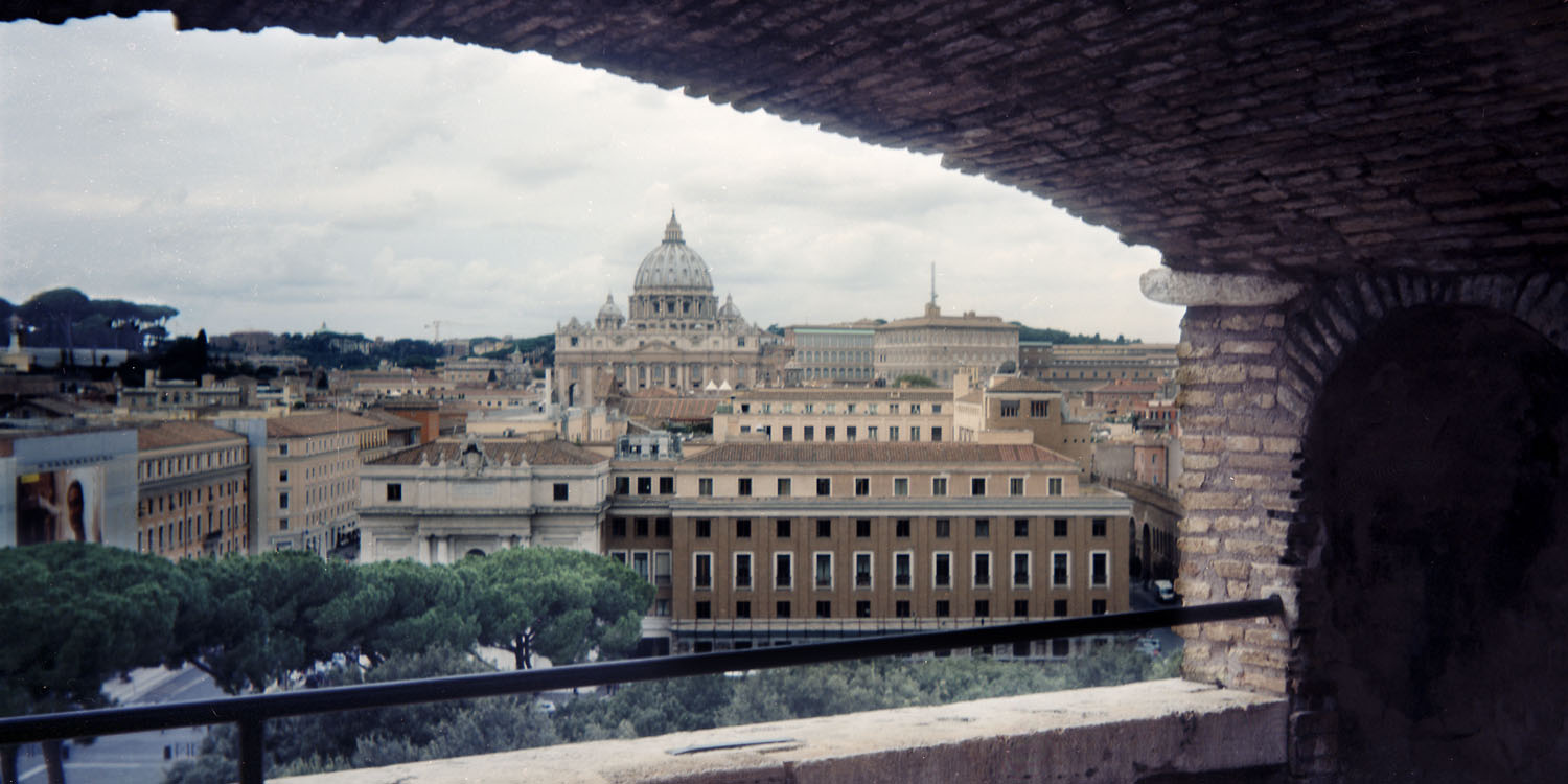

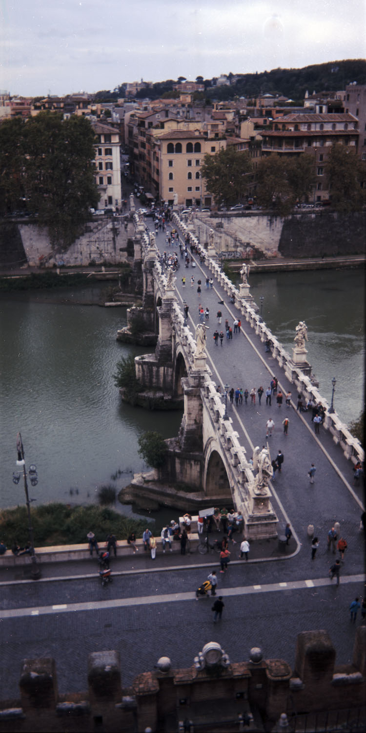

The 90mm is a different animal, or at least a first cousin. Still a plastic lens, it has more contrast and much less distortion. I was reasonably satisfied with the results I got from it, within limits. I did make some images I'm pleased with:

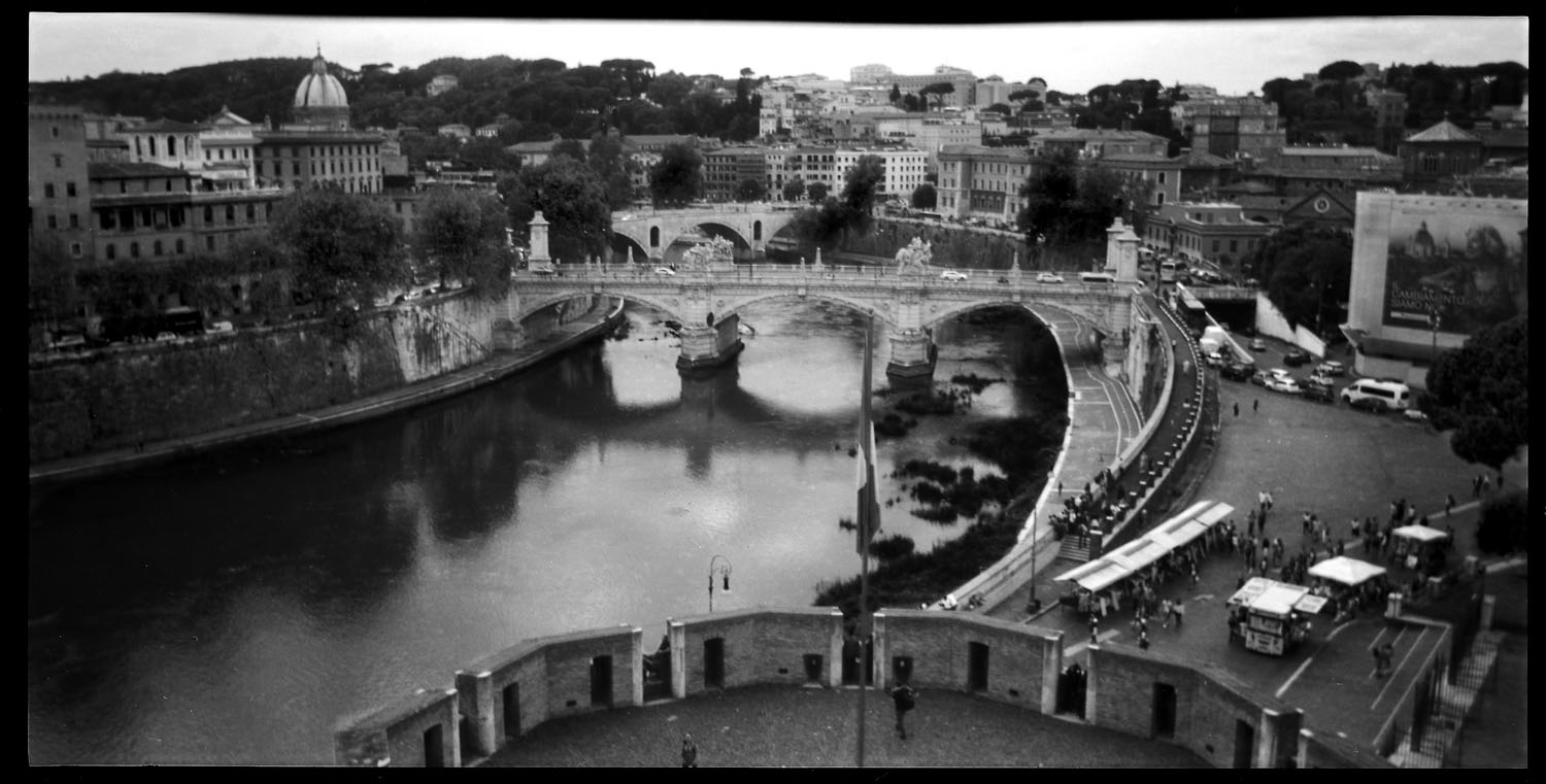

In the Tiber River panorama, you can see another of the quirks of the camera - it has a purely manual red-window-based film advance and no pressure plate to speak of so the film usually bows or sags a little when in the gate, producing the curved top margin you see in this frame. Also as you can see, none of these are terribly sharp - better than the 58mm lens, but not exponentially so. You're not going to blow these up to 24x48 inch prints and expect to be able to read signs in the background.
The 90mm also does not have the flattest focal plane in the world either - this shot was taken at f/16 @ 1/125th if memory serves, and focused by guesstimation at the 9 meter mark (that's all you can do- the lens has markings for four distances: infinity, 9 meters, 3 meters, and 1 meter). In theory this should have put the whole tree in sharp focus, but you can see that the upper middle of the tree trunk is sharp but the lower trunk and the canopy are not. In the right light, with the right composition and subject, the 90mm is capable of producing reasonably sharp detail (vis the tree bark).
