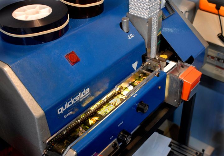

John Salim
Apr 15, 2014
239
Southend Essex
Yes, it's a totally different design John. These ( type DS ) Gepe mounts are single piece ( white & grey halves welded together ) and have openable sides.
They can in fact go into the machine any way round ( horizontally ).
The mounter will cycle like this....
A mount already in receiving position will have one side held bent open.
1, a guillotine cuts the frame.
2, two ( soft plastic ) clamps grab and pull the film inside the mount ( into final position ) - and then release.
3, a metal sliding plate pushes a new mount into position - which pushes the mounted slide into a receiving box ( the mount's end will spring shut as it exits the mechanism ).
4, a claw will advance the film halfway into the new mount.
( start again at 1, )
The only operational adjustment is the frame line ( perforation position ).
John S 😎
