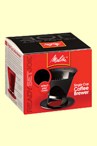

I was filtering my Amidol through a coffee filter too until I read on M&P's site someone suggested a cotton ball in the funnel. I tried it and it worked faster than the coffee filter. So that is how I'm filtering it from now on.
I add extra Chinese Amidol because of the loss of sludge, ten grams per liter.
I am using a #2 cone shaped coffee filter in a Melitta plastic conical single cup coffee brewer. I think that is the KEY. Works far better than the cotton ball in the funnel method (at least it has for me).
I've added a small pic of the Melitta product.
