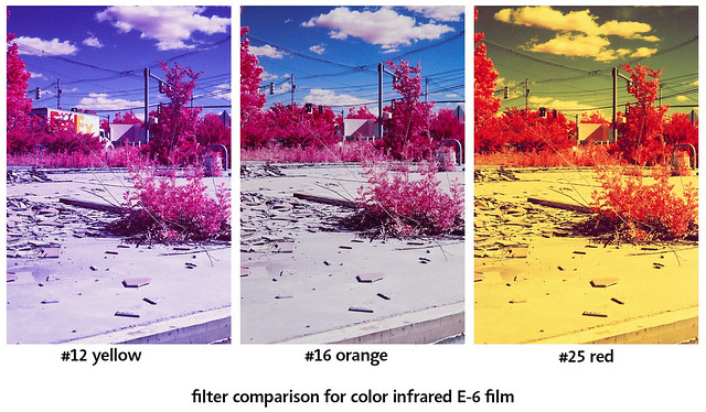

For color infrared use, anything from #12 yellow to orange will be ok. I wouldn't go too deep with the orange, though. The #16 orange is probably better than #21. Seems like the B+W 040 and 099 filters are closer to #16 light orange.
I have a comparison shot with #12, #16, #25 filters:
Thanks, mjork, that's great information! I appreciate it. Especially the recommendation of #16 orange over a #21 orange filter.
