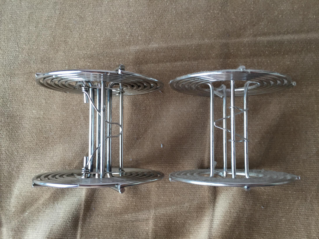

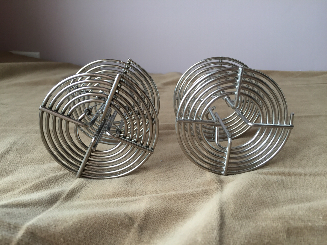

First, The pointy metal clip should be pointed towards your film.
With all due respect, that is correct, except when it's not. I've used SS reels where the clip should point one way, and ones where it points the other...
I've never a 120 reel like that before. I've seen 35mm reels that have metal prongs which point in the opposite direction that grab on to the film puncturing it. Learn something new everyday.
Richard S. (rich815)
Jan 14, 2003
4,924
San Francisco

The reel on the left would throw me off in the dark. Which one do you prefer?
The one on the left is a Hewes and what I use most often so I'm used to it, and either is fine based on what you're used to. That said I only have 3 Hewes 120 reels and on rare occasions I use a large tall SS tank that can hold 4-120 reels and a 35mm at once. On these occasions I use one of the non-Hewes reels (which I'm pretty sure is a Nikor) and feeling the shape of the "spring/prong" I can figure it out, besides doing it the wrong way won't work!
