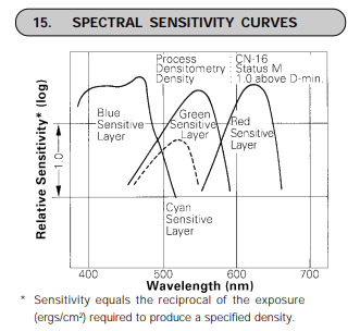

In order to correctly answer your question, you need to have information about what kind of film you are going to work with. You should always first study the manufacturer's datasheet. They contain graphs of sensitivity to different regions of the light spectrum.
Here's an example (Fuji Superia 200):
https://www.fujifilm.com/products/consumer_film/pdf/superia_200_datasheet.pdf
As can be seen from the attached graph, the sensitivity of this film does not apply to the spectrum above 700nm.
However, I would recommend using a 950nm camera and backlight. They are not expensive in Chinese online stores. I myself use a bundle of 950nm WiFi camera and smartphone (I made a special cardboard box with sleeves).
