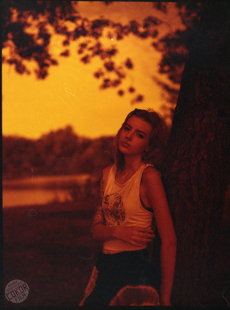

So I loaded a roll of 220 film in my mamiya m645. I'm wondering if light would hit the film still. As I know with 120 the backing paper would block the light. Is 220 the same or is the middle of the roll just film with no backing paper?

You'll probably end up with very soft, underexposed images.

The usable exposed section of type 220 film has no backing paper.
Basically that "twisting" of films is done commercially as for instance with "Redbird" film.
exactly - so some light would still get to the film. but you'd be exposing the non emulsion side so your images will not look the same as if the light was directly hitting the emulsion. With 120 loaded backwards there is no way an image could be formed.

220 has no paper backing where the film is. If the film is black and white, it will probably come out fine, maybe slightly underexposed because the base of the film is not completely clear, but acts as a bit of a filter. The emulsion being on the other side of the backing may result in a slight focus error making some images soft if shot at wide apertures. Of course, the images will be reversed left to right, so you will have to put them backwards into the enlarger or scanner to get them the right way around again. If the film is colour negative, the orange base will be between the light source and the emulsion, so you will get 'redscale' results, which some people intentionally do for the effect. There will be a red tinge to the whole image. If the film is slide film, I'm not sure what the results will be.

just sent the roll off to the lab today. So if the film turns out I'll for sure post scans.
And thanks for all the info
I need to correct myself, about black and white film, at least. I forgot most have an anti-halation layer on the base to prevent reflections off the clear base. Thos washes away during development, but is there during exposure. So the film will likely be severely underexposed. When colour neg film is exposed backwards for the redscale effect,
i believe the usual practice is to give it a good 4 or more stops extra exposure.

All modern films have a antihalation layer of some kind.

So I got my film back from the lab and I'd say it turned out nicely. Redscale works pretty well with Kodak Vericolor III.
yeah looks like they got some useable images out of it - you can see from the darker areas that the negative was pretty underexposed but it looks nice in the end!
