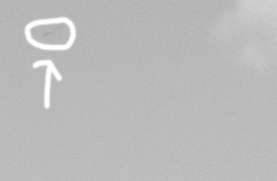

I pre-soak for about 5 minutes, hc110 1:90 for 8 minutes, stop 3/4 strength for 1 minute, fixer at film strength for 5 minutes, permawash for 5 minutes, archival film washer for 30 minutes, distilled water and LFN. Here is an example:

You’ve shown a short somewhat irregular line. Obviously, it’s not an air bubble.
Since the line is dark and you described these as” little spots of less density”, I presume the negative has been reversed to positive.
Given the shape, I wonder about the size. Might it be about the size of a tiny fiber from clothing?
I’m thinking not of threads, which are relatively huge, but rather the very tiny fibers that we can sometimes barely see in beam of sunlight on the surface of, say, a cotton or cotton-polyester blend shirt. I can’t see them unless I’m wearing reading glasses.
I’m wearing such a shirt now and can barely see many fibers that I’d estimate are 0.0001” or less in diameter and possibly 0.020” or somewhat longer. If it weren’t for the beam of glancing sunlight I probably couldn’t see them at all.
Film can be much like a magnet while we’re loading holders in the dark. That will draw almost any particles to it.
The fibers I’m seeing are almost translucent. Something like that might well correspond to what you’re seeing.
If there were only few here and there, the idea of stray fibers might make sense.
If there are a great number of them, then I’d reject the idea.
Possibly someone else has a better explanation.

Ian,
You really think it could be from fibers so small and fine that light could get through it but not all the way through it? It's not as though the negatives are littered with these specks, but I have been noticing them a bit more. My film loading area has been more dusty than usual. They are darker spots in the print and lighter on the negative.

If the spots (more of a line in the example shown) are the result of bird flight paths, then the birds must have been darker colored than the surrounding sky (unless they were in silhouette). This is possible, but is something that you should have noticed just before shooting. If this is the case, you need only wait for a lull in the action and then shoot without the bird blurs.
I did some spotting on a 16” x 20” print from 4” x 5” T-Max 100 negative last night. It’s an early morning view of trees, beach, and marsh grass looking out across Lake Erie towards the distant shore of Ontario.
The negative has a single small defect in the sky area similar to what you showed. It prints as a slightly curved line of moderately greater density than the sky. If it were lighter than the sky it would be easy to spot dye it to match the surrounding area.
The edges are somewhat fuzzy. It’s not black and that means that the image of the line on film is not transparent, just lower density than the surrounding area. It was most definitely not a bird as I made sure that no birds were flying across the scene before shooting.
It’s just enough to be annoying on close inspection. If it was over a darker element, it wouldn’t be noticeable.
On the print, the line is about 4.5mm long and 0.3mm in width. I’m nearly certain that it was caused by the shadow of a micro fiber that had clung to the film during exposure. The magnification of the projection was about 4.7X, so the image of the line on film is about 0.97mm long and 0.06mm in width (or 0.0025” wide x 0.038” long).
No matter how careful we are, sometimes particles of various types stick to sheet films or the holders, or dark slides. There’s no escaping handling sheet films. Particle contamination can be minimized by careful housekeeping in the film loading area and cleaning of the holders. Unfortunately, we can’t totally eliminate the problem.
We all know from observing a shaft of sunlight in a darker room, even one that is scrupulously clean, that there are always visible particles floating in the air. These can adhere to films and cast their shadows during exposure.
I have seen these artifacts on my sheet film negatives occasionally and compared their size and shape to the fibers mentioned in post #5. They seem to match.
One trick that I’d read about years ago might help. Some folks run a room vaporizer for a few minutes in the film loading area to settle dust and help eliminate the static charge that draws particles to the film.
I’ve though of, but not tried, the idea of using a grounding strap that fastens around the wrist with a conducting wire clipped to a bare metal water faucet or the metal case of an electrical outlet to ground us while we load sheet film into holders.
The idea is that any static charge we generate through friction: tearing open a sheet film packet, sliding the films out of the packet, sliding the films into the holder, etc. are discharged to ground so that no attractive charge forms in the first place. Such grounding straps are ready made and inexpensive. They can be bought at Radio Shack or other electronic supplies stores.
We might also place the holders on an aluminum cookie-baking sheet with a length of copper wire and a couple of alligator clips to connect the sheet to a convenient source of ground. Whether these steps help can only be determined by trying them.
I’m not aware of any film manufacturing errors or processing errors that would cause these marks on films. That these occur almost exclusively with sheet films and not roll films lends credence to their being caused by very small fibers sticking to the emulsion during exposure.
This can happen to a roll film, but only rarely. If the film chamber of a roll film camera is allowed to get contaminated with dust and particles, some of them can find their way to the film and cast shadows during exposure. But a roll film camera whose film chamber is brushed and blown out regularly rarely accumulates particles to cause the problem.

Processed more negs with the same issue. It is definitely not dust. I dilute my stop bath to it's normal strength so I doubt that it is that either, but it could be. They are all processed in a Jobo 3010 with constant agitation with a 5 minute pre-soak. These are spots of less density not zero density. There are no marks on the surface where something would have abraded the surface. They happen in the skies of my negs for the most part, but not to every single negative. Perfectly even skies, but just these little spots of LESS density. Any more ideas yet anyone? Thanks in advance.

Almost looks like a kink mark from loading or unloading the film holder pre-shot, or loading the developing equiptment.

How fresh is your fixer? The reason I ask is that a while back I had an issue with what looked like pinholes with uneven edges on occasional frames of 120 film. I believe I traced it down to fixer. I used to mix 2L batch of
1:4 fixer and use that over several weeks/months as one-shot. When the fixer got older the spots started to appear on film. Running the fixer through a fine filter and eventually switching to always fresh-mixing it seems to cure the problem.

I'm going with the idea that something is interrupting exposure rather than development. View camera bellows have been know to harbor dust, lint, etc, especially in the folds, which can block light while airborne near the film, but not on it.
How often do you remove the bellows, clean, or vacuum out the bellows, etc? Also, I've had this happen on dryer, windier days. I used to carry my camera flat in a case, then assemble when arriving at the shooting place. Once I changed the case to allow the camera to be assembled all the time, just opened to change the lens, or film holder, the dust frequency diminished.
You may not be doing all this, but it's just a thought. Also, if possible, after inserting film, cocking the lens, I wait a half a minute or so, if I can, to let the inside air settle before pulling the dark slide. I don't know if any of this will help, but if this is a recent problem, depending on your location, it could be dryer and breezier than it was a few months ago.
