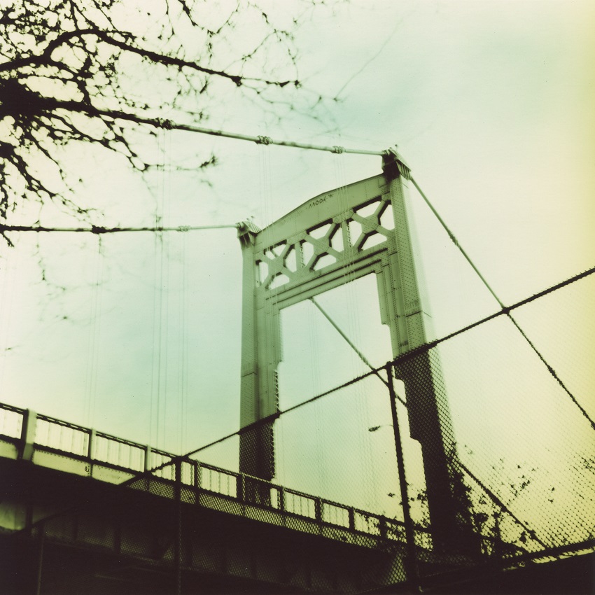

Thanks for the feedback, but I'm pretty sure my RA-4 process is fine. I've made color prints from black and white film before and not seen anything like this (I get a range of tones but of a single hue). Also, if it were my process, I wouldn't expect to see the tones show up the same way every time (using the same exposure and filtration settings). Also worth noting is that I see the same thing when I make a raw scan of the negative (i.e. all adjustments are turned off) -- the image is grayscale with blue appearing in overexposed areas (skies, snow).
Here's an example. The filtration is deliberately set toward yellow, but you'll notice greenish or cyan tones in the sky.

I think you are missing the point bvy.
Black and white films may have certain color casts because of any number of reasons like using a Pyro developer or improper washing or poor fixing or nose oil or ...
If the negative has a color cast it would produce odd results on color paper. That doesn't mean in any way shape or manner that it has carried over a color purposefully from the scene to the paper.
You hit a few points. I do believe the colors are in the negative, but do not believe they correspond to the colors in the scene (except maybe coincidentally). Also, the f295 post that I mentioned in my OP attributed this phenomenon to the developer. I had forgotten that point. He was using a homemade developer. I achieved the same results with Ilford PQ at 1+14. Maybe that's all it is.
