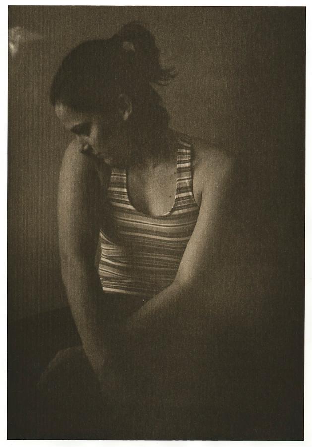

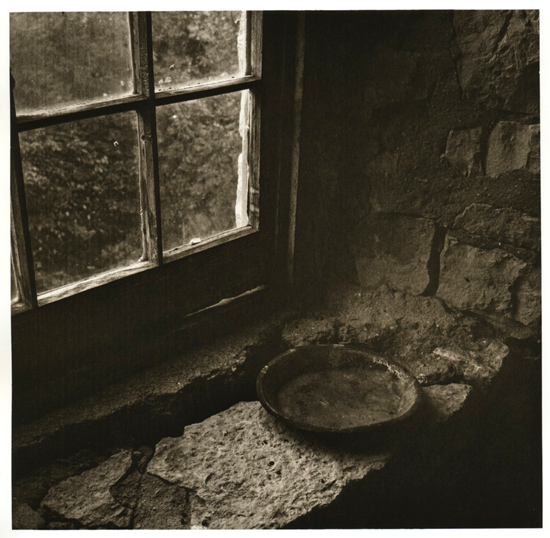

I took the plunge on lith printing yesterday, using some Kentmere Kentona paper and Fotospeed lith developer. It was very interesting, and I came out of it with some pretty interesting looking prints.

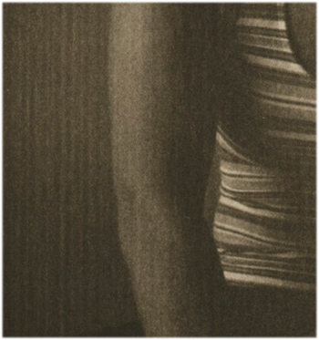

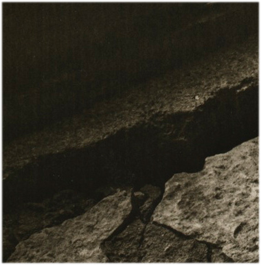

I did encounter a problem, however. I see 'stripes' across the print that are not there in the silver gelatin print. See the attached pictures.
Any idea what this might be? I'll try to process a sheet of the Kentona in normal chemistry to see if I encounter the same problem.

Thanks Anne Marieke and Mark for your suggestions. I agitate the whole time the print is in the developer bath. Fortunately, Kentona develops rather rapidly, at least compared to the Fomatone and Ilford MGWT papers I also used yesterday.
The banding appears regardless of developer volume. In this case the print is on 8x10 paper in a 10x12 tray with 1 liter of fresh developer and a dash of old brown. The Kentona develops non-uniformly in standard chemistry as well, so I'm sure now that the problem is with the paper, and not the chemistry or my processing. Fomatone and Ilford MGWT both developed fine.
Mark, perhaps you need a monitor with better separation in the shadow details, I see the patterns just fine on my laptop. Below is another exampe from a print I made last night, perhaps it shows up clearer.
