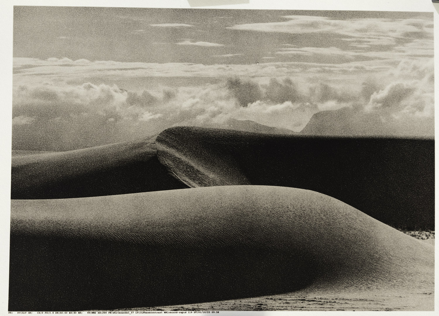

I've been doing lith printing almost exclusively. I have developed a one-shot approach with just a touch of warmth, color, infectious development and grain. It doesn't look 'lithy' but nobody would mistake it for a inkjet print.

Beautiful! It looks lith to me for sure.
What do you mean by one-shot? Infectious development refers to lith but it isn't?

One shot means you only use it for developing one print. I have a crock pot to heat it in while I expose and a tray warmer. This way you can get a consistent result... lithy but not too much. I also add benzotriazole and use higher concentrations to keep the color and grain from going too crazy. I use Arista lith developer which is really inexpensive but am doing trials with home made Ansco 70 to see if I can go without formaldehyde. Since it is one shot I don't care about tray life.
Also, keep in mind the print above is only 5x7. It would look a lot less grainy 8x10 or 11x14

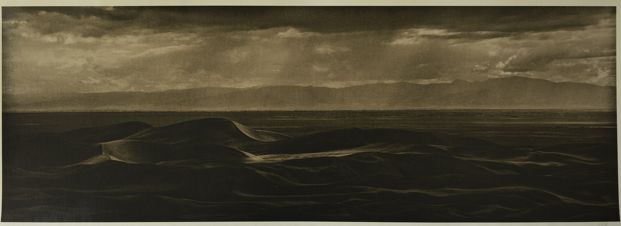

No reason to wait so long, using heat my development times are down to 3-4 minutes. You could try Foma Classic which is very fast even without heat. It is very flexible you can get many different colors and looks from it. It even responds to multigrade filters, the attached print was Foma Classic with 3.5 filter.
