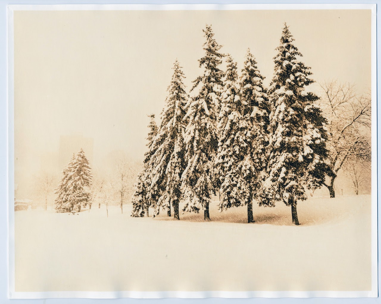

I received some Fomatone 131 today, sure hope it liths! Hopefully next weekend I'll have some time to try it.
I have used Fomatone 132 and 133 with Moersch SE5 and have had good results.
I think this was 133, not totally sure. 133 is usually a bit more orangey than 132.

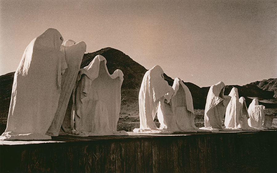

Can't say I've had any issues at all with snowballs, but I've only used Foma 131 with Photospeed LD20 developer. I don't believe LD20 is available anymore (crap!), so I'll probably try Moersch EasyLith next.
131 has a fairly warm tone, but Kodak Selenium toner cools it down quite a bit.
