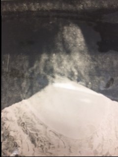

IMG_1153.JPG Has anyone had problems Lith printing on Arista Ultra FB paper? I have had 3 different packs of paper print with very distinct lines across the print , or bands of much darker areas in the exact same place on every print . It's not the developer because I have gotten the same result with different batches of developer.

This is difficult to diagnose at distance. The Arista Ultra FB is made by Foma if I am not wrong and should Lith nicely.
Have you lithed before? Can you described your overall process, which developer are you using?

If you are well experienced with lith printing, ignore this. Otherwise it looks as though the problem might be in the way the print enters the developer and how well it is agitated early on. I had similar artifacts when I first started lith printing.

Yes I have been Lith printing for several years, my developer is Arista part A and B lith developer. I have been using Arista paper for the whole time and never had any problems, but the last 3 packs of 16x20 have had this problem . My process is 1 part A and 1 part B to 18 parts water, agitate for about 20-30 minutes.

I am pretty experienced, I have only recently been having this problem. The lines are happening in exactly the same place on every sheet! I am hoping this is just some bad batches of paper and that the problem will not continue. It's the only paper I have found so far that I like for lith!
I wasn't aware that any arista papers lithed properly. If it's rebranded Foma, only a couple of those will work. And when foma changed their gelatine, I think all their papers had non-lithable batches (a year or two back), but that was more globby blotchiness than (what looks like) coating errors on your example.
Keep in mind Freestyle has a great return policy, contact them, send them an example scan, they should refund or replace. Also, Foma 123 has been re-released in a lithable/bromoil-able emulsion as sort of a test project for Foma. It's available in 8x10 now, with 11x14 and 16x20 due June 30th. According to Freestyle, if it sells it may become a regular production item and has their money back guarantee as well.
Reports from the Facebook lith group have been promising, you might want to try a batch - I'm waiting for the larger sizes. Hopefully everyone will support this and Foma will make it regular stock or may do special batches.
Have you tried developing a sheet conventionally?
Could be you picked up a batch which does not Lith properly, could be another problem maybe from packing/transport/storage.
I have not tried the Arista Lith Developer, but that should not be the problem ...
