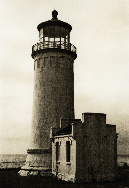

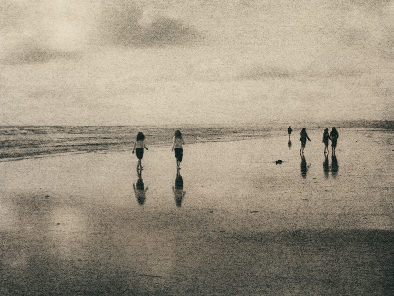

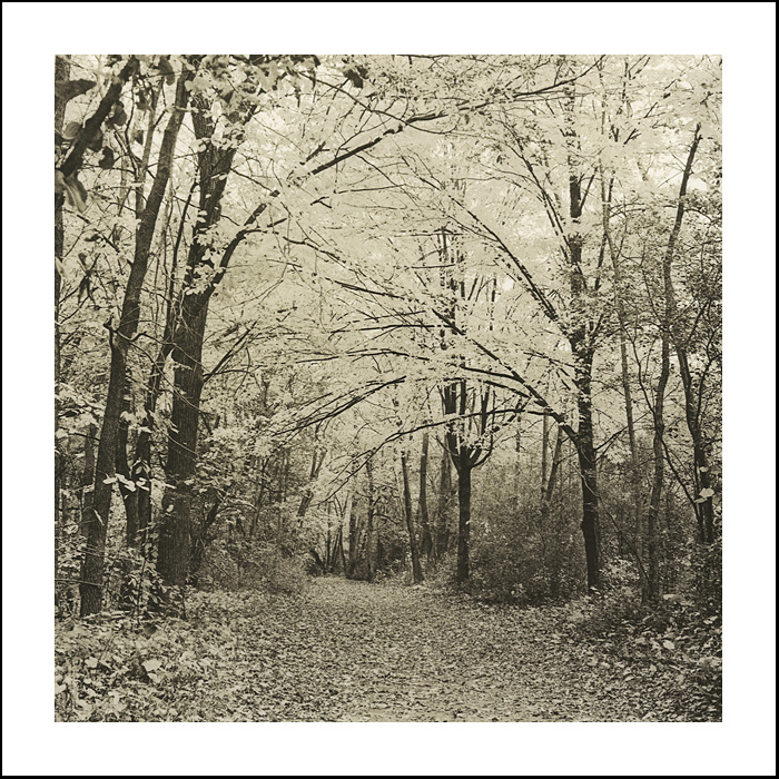

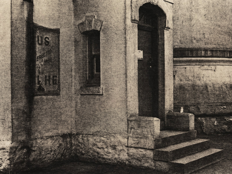

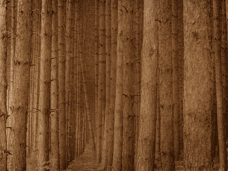

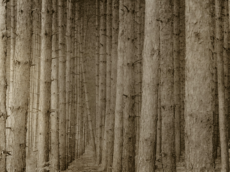

Attached are some prints made with Ilford MGWT in Arista Lith. All are double toned in both sulfide and selenium toners to varying effect. The print of the trees (attached for illustration) were identical to begin, and the toned difference is that the copper colored one had twice the amount of time in the selenium bath. You can do anything you want with this paper, if you try hard enough.
