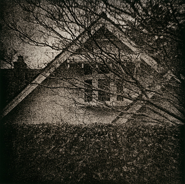

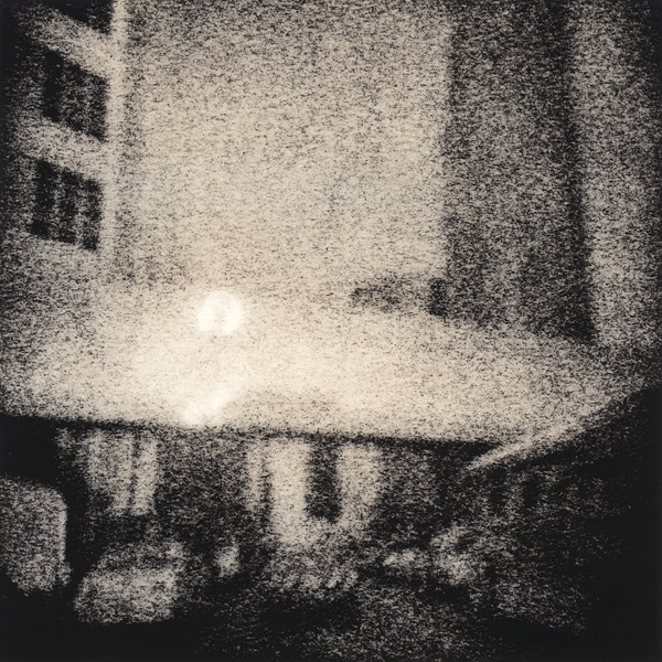

Bob, the Fomatone MG Classic 131 (glossy) and 132 (matte) are the ones that produce very warm images with orange/pink salmon hues... I've attached a sample image here printed on Fomatone 132.
Fomabrom Variant (III) 111 (glossy) and 112 (matte) give a grainy gritty print quality that can be amazing, especially in really big prints. For smaller prints it's an acquired taste. That's the second image I attached here for you on Fomabrom 112.
The Fomabrom Variant (IV) 123 has a slight velvet grainy finish that is great, and gives wonderful grain and warm tones something in between the 132 and 112 above.
