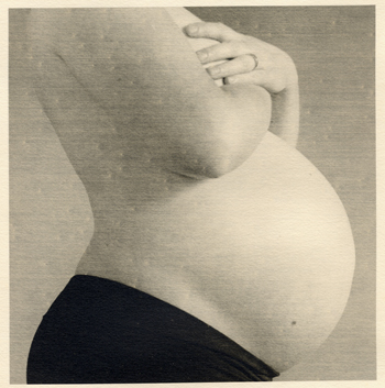

I bought Foma Chamois paper, and have tried lith printing on it. I do OK if I let all shadows go black, and keep the highlights very high. With any midtones I'm getting white spots. White pepper?
I've attatched a photo showing the spots, with a companion of the same image on chamois as a regualr print.
Any advice would appreciated.

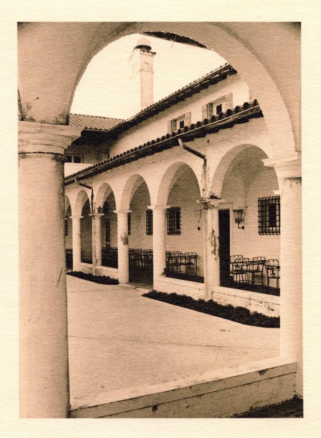

I like Foma Chamois for lith
This is what I get with lith on Foma Chamois

I like it! Love the peaches and cream of it. I knew I'd seen some lith on Chamois that appealed to me on APUG. That's why I ordered some.
What developer, dilution, temperature do you use?
bill williams
Mar 11, 2005
73
Ok, sorry but I don't remember all the details, but my typical run would be Fotospeed LD20, 1:12 to 1:18, 69 to 72 degrees F, and times would depend on how many prints had been though the developer and the dilution. Likely in the 8 to 10 minute range or perhaps longer. Of course the exposure is important too. The photo is of Crane Cottage on Jekyl Island, back when it was used for GSP barracks. It is now part of the hotel complex next door.

How long ago did you print it? Is it possible the emulsion is not the same as the batch I bought last summer?
bill williams
Mar 11, 2005
73
It has been a year at least. I noticed you used a different developer than I do. I've use the same one that you used for your print, but I find much better and more colorful lith from the Fotospeed. And, it seems to me to have a very long shelf life.
