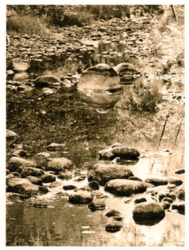

After the fact, for what it's worth, I don't want to contradict Tim Rudman and his genius, but I've had no problem at all getting good contrast with the recommended dilutions from Fotospeed. I've made it work by adjusting the contrast and using lots of developer. I mix 3 liters of working solution every time and keep it at about 75*F.
Attached print is on Fomatone in Fotospeed LD20 developer at the recommended dilution. I think you need to experiment more with exposure. If your negs usually are thin, the exposure will be rather short and your development times long, but it can certainly be done.
With that said, I can see how a stronger solution would be more active, not exhausting in the shadow area as much and developing those blacks quickly with the highlights pretty much intact.
I think for your situation a combination of shorter exposures and stronger developer would be the best solution.
