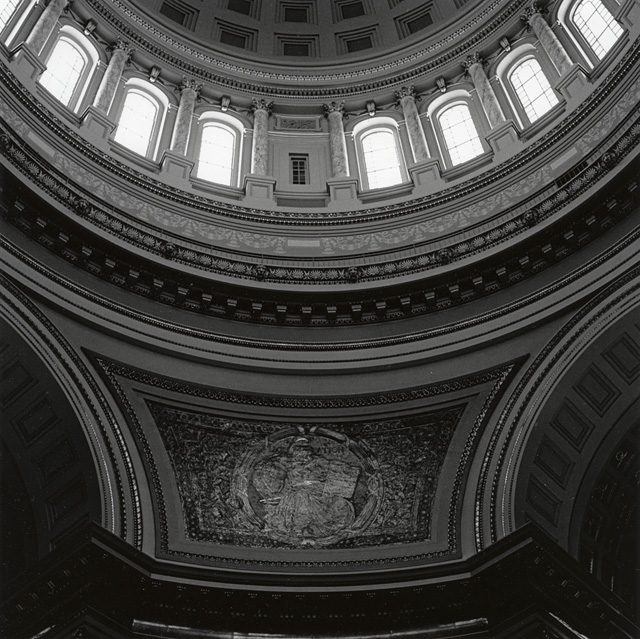

To the OP: Re - high brightness range.
The attached print is from Tri-X film, photographed inside the Wisconsin State Capitol in Madison. It's hand held as they didn't allow tripods, and shot at 1/60th of a second at f/4 with an 80mm lens on a Hasselblad camera. The windows had full sunlight coming through them. 1/250th second at f/16 would have been appropriate to capture them with normal development, but of course that would have left everything else completely without detail, or close to.
I shot the film at box speed, EI 400, and developed using semistand with Pyrocat-MC, at 1+1+100 dilution, 70*F, 13 minutes agitation for the first minute, then at 9min, 6min, and 3min for 10s (2 inversions).
This is a straight print, at grade 2, using Forte Polygrade paper and Ansco 130 developer. There is a bit more shadow and highlight detail in the print, but this gives you an idea about exposing for the shadows, and develop for reasonable midtone/highlight detail.
I didn't like the print very much, so I didn't take it further than to this work print. I'm glad it can serve a purpose here.
- Thomas
