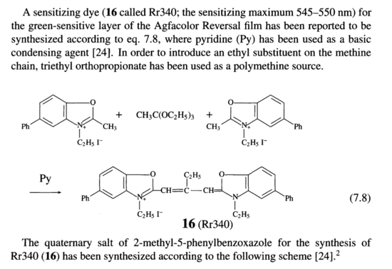

possible answer to Rr340?
So, those were 3 hints to me, along with the unknown solution which is virtually impssible to decipher unless the destription is given somewhere in Steigman's work. I doubt Grant would leave it out if published, and if not published then it was a secret 'magic elixir' added to adjust the contrast. I have not looked it up and have not bothered Grant for more information.
PE
Hello PE,
Just out of curiosity, I entered "Rr340" into the Google patent search, and it popped up in patent number 2930693, where a "Rr340" is listed as a "green sensitizing dyestuff". Could this definition of "Rr340" be a possible fit as used in this formula?
Thanks,
Bob M.

Yes, it might be. This is not a Kodak designation for a green sensitzing dye though. In fact, it is not a Kodak designation for any dye at all AFAIK. Therefore, if used by Grant it would be from a patent, old document or by private communication.
The actual structure may be unknown to us then unless you can get the BIOS report referred to in the patent. For those of you unfamiliar with the BIOS reports, these are the disclosed AGFA formulas published at the end of WWII. The formula is stated in the patent to appear in report 1355 page 86.
Under the circumstances, any green sensitizing dye might work, but I'm not familiar with the need to spectrally sensitize lith emulsions.

thio
Jan 31, 2015
34
Russia, Moscow
About of Rr340 dye - see the book S. Fujita - Organic Chemistry of Photography (2013), p. 122
Photo Engineer
Photo Engineer
Apr 19, 2005
29,018
Rochester, NY
I have since found a reference to the dye myself. It is probably known to the Japanese due to exchange of information between Agfa and the Japanese companies in WW2.
The reference is in Haist, but I don't have it handy. If I find it next time I dig out Haist and if I remember, I will post it.
