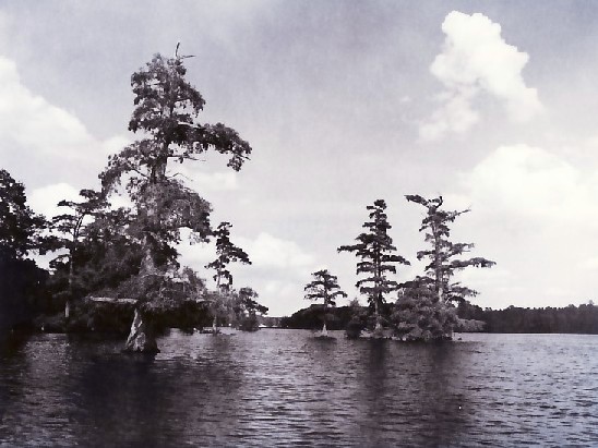

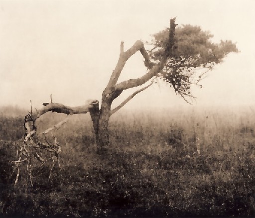

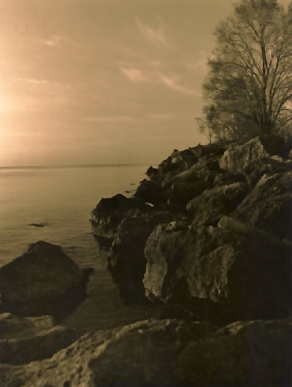

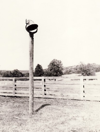

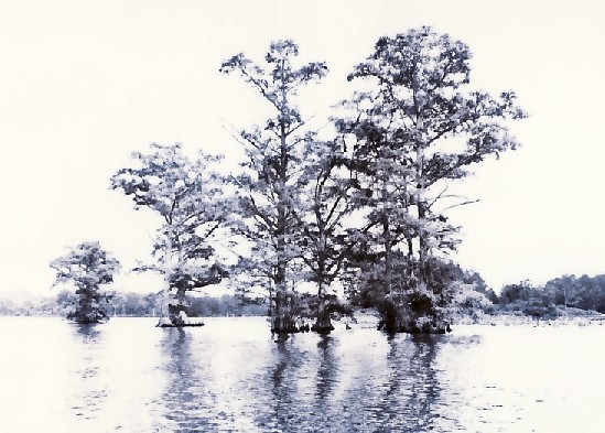

OK, here are the lith prints that I made using Foma Fomabrom paper. These were made about a year ago.
  • Appomattox Bell - Maco Superlith 1:19, 25% Old Brown, Selenium Toned
  • Chickahominy Trees #1 - Maco Superlith 1:19, 25% Old Brown, Gold Toned
  • Chickahominy Trees #2 - Maco Superlith 1:19, 25% Old Brown, Gold Toned
  • East Humber Bay Sunrise - Naccolith 1:19, no Old Brown, Untoned
  • Hogcamp Branch and Hemlocks - Naccolith 1:19, no Old Brown, Selenium Toned
  • Tree and Fog - Naccolith 1:19, no Old Brown, Untoned
I'm not crazy about a few of them, but I just posted them to show how this paper can lith print untoned, gold toned and selenium toned.

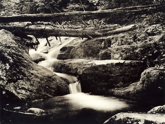

The "East Humber Bay" print typifies, for me anyway, the beauty of the process. Colours emerge that really make the print something out of the ordinary, even when untoned.
