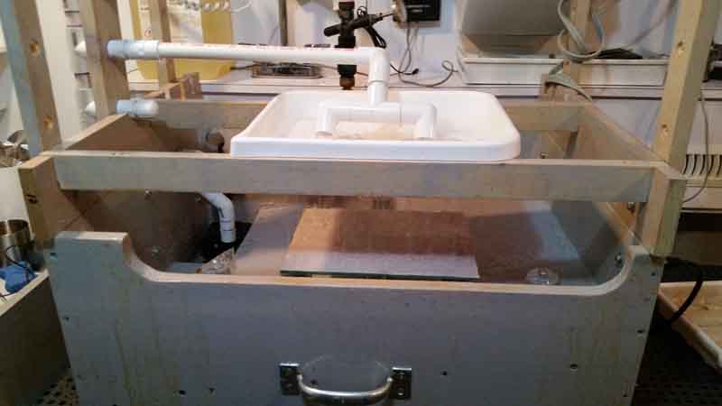

Back in 2009 the thread below talked about about circulating lith developer with an aquarium pump to tame Slavich Unibrom’s uneven development issues. The pump method should also be excellent for any other lith paper where development is an issue.
Months ago, I emailed the two Russian photographers that Tim Rudman cited, via their websites. I asked them if they might share any ideas or pictures of their setups but neither one answered. They suggest they deliver the developer to the center of the print. My first thought is that there would be a lot more action there where the developer drops than there would be at the edges. So I'm thinking more of a whole-paper "shower". Crazy talk huh?!!!
Anyway, I'm undertaking to make such a setup and wonder if anyone has experience or suggestions, or is interested in my results.
Mark

Ok...I've started building the contraption! Richard, Gerald and Rudeofus: thanks much for your interest.
I wanted to report that I built my “lith shower” contraption, and have done substantial testing with 8x10 Slavich Unibrom grade 3. Of maybe 15 prints, I had no unwanted random infectious development anywhere on the print, and development seems to be perfectly even across the surface. I’ve ordered 11x14 to try next. If that develops well, I’ll move on to 16x20. There’s a chance that there will be development issues with the larger sizes, but I’m very happy about the results so far!
The test prints were so consistent that I was beginning to think that for this image and this developer, it might develop just fine with the usual method of tray development. So for an identically exposed 8x10, I used an 11x14 tray with fresh developer of the exact same quantity and ratio (no old brown) that I was using in the contraption. I rocked the tray gently but the very first print had the uneven development and random areas of dark overdevelopment that make Unibrom so hard to handle.
This setup was quite a bit of trouble to design and build, because I wanted it to handle up to 16x20 and wanted to accommodate a wide variety of solution quantities. I went to the trouble because I have a stock of discontinued Emaks paper that had the same finicky uncontrollable development in lith as Unibrom, and I burned through a lot of 16x20 trying unsuccessfully to make a certain image. So, I’m testing this method first with Slavich because it’s currently available (and is also a very cool paper in lith). Both papers can produce a lot of “artefacts” in lith, which may or may not be desirable depending on what you want. But at least there aren’t those nasty black overdeveloped areas anywhere, much less the edges!
I think another advantage of this system is that I believe it substantially speeds up long development times with very dilute developer. The many streams of developer impacting the surface seems much, much more dynamic than slow rocking of a tray. This would hold true for any paper, not just difficult papers. The disadvantage would be building and storing the thing, and also the increased oxidization of developer. A future improvement will be heating the developer. Currently it only circulates at ambient temperature.
If anyone is masochistic enough to want to build one of these, I would be willing to help you along. There are likely improvements to be made to this prototype, but so far, so good!
Mark

Could you post a picture of your device? I'd be interested in trying something similar out.
