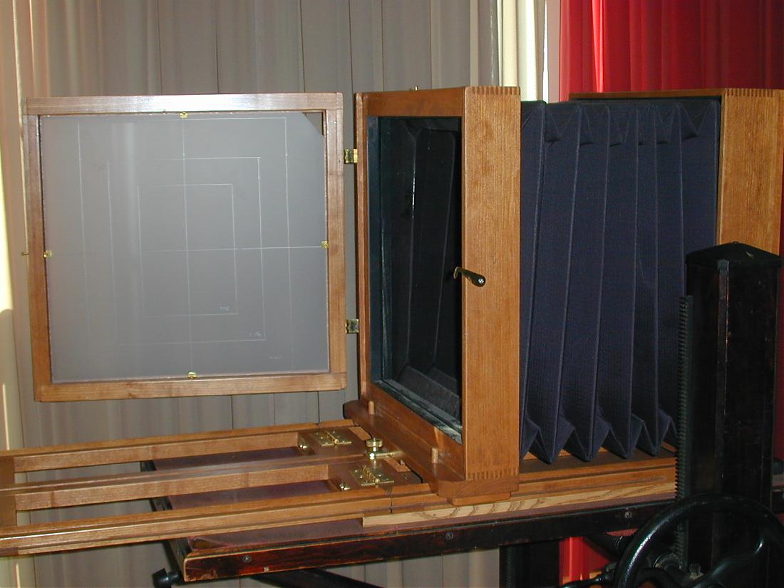

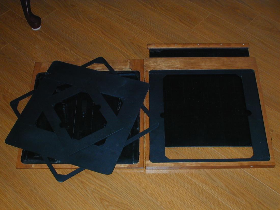

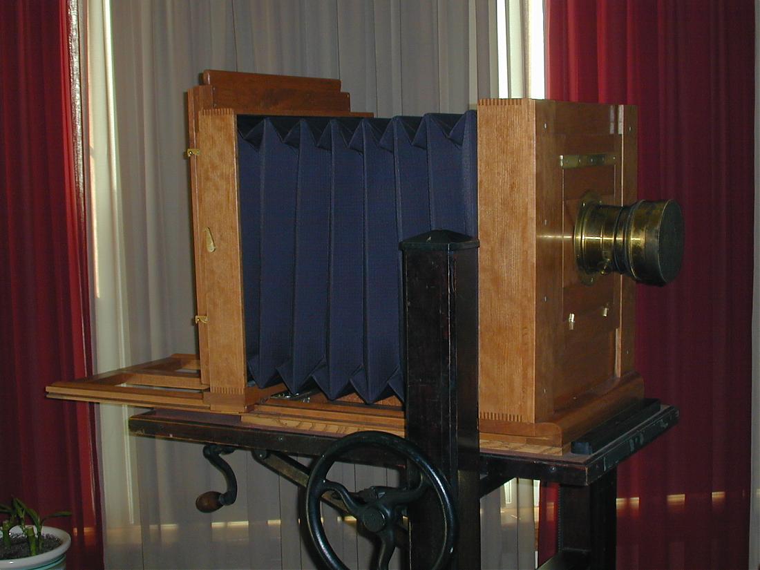

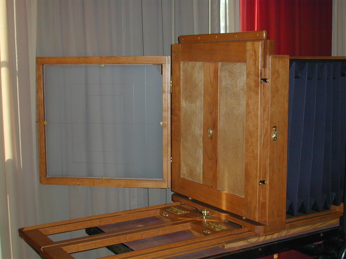

(there was a url link here which no longer exists)(there was a url link here which no longer exists) The first pic is a tailboard camera with a wetplate back. The door swings open after composing and then the wet plate holder is attached. The wet plate holder in the third pic is shown with the darkslide pulled up a tad and the assorted inserts (the part that holds your plates) are shown. This particular camera will shoot 5x7...8x10....11x14....14x14. But you don't need this. You can have a film holder converted to accept your plate. The plate holder is shown with the 11x14 insert installed. The fourth pic is the camera set up and ready to expose a plate. The lens is a Jamin- Darlot Cone Centralisatuer about 16" it will cover 11x14 at portrait distances. I think it was made for only one year...1861. But like I said you don't need any of this to shoot wet plate. Just have a film holder converted to accept your plates. You can use the camera you have for film and wet plate.
