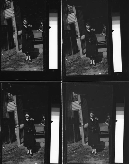

Appended it a 72 hour open tray (8x10) with 1L of Liquidol. Each 24 hours I ran a set of prints through it. The left set is Liquidol and the right set is Dektol. In this set, the developer concentrate was made with tap water and diluted with tap water. The test went to 120 hours, and by then the Dektol was dead, but the Liquidol still made acceptable prints. These were all at the same process times and temps.
If I increased the development time in Dektol, it did not help, but with Liquidol it brought the picture pretty much up to the original.
PE

Wow!
Thats impressive. Something certainly is wrong with mine.
Thanks for the baseline.
